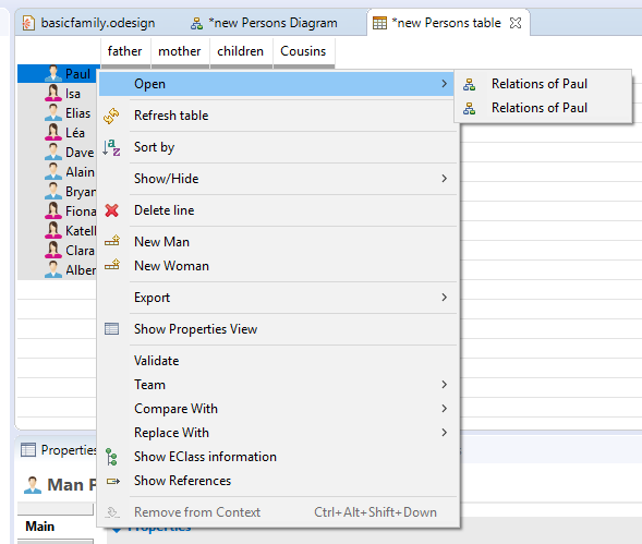

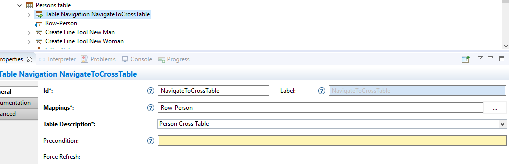

Please find here I attached images of basic family
index.php/fa/34049/0/ index.php/fa/34050/0/
where I gave the mapping- line name
and table navigation to target(existing table )- cross table
I am not getting what I gave wrong here.

New Table creation I tried and that is working and table navigation also in some condition it works for my model. When I gave browse expression var:container in the advanced tab it is working in my model.
But in basic family it did not work.
Even though I got the solution for my model still not clear with the usage of that!!..
