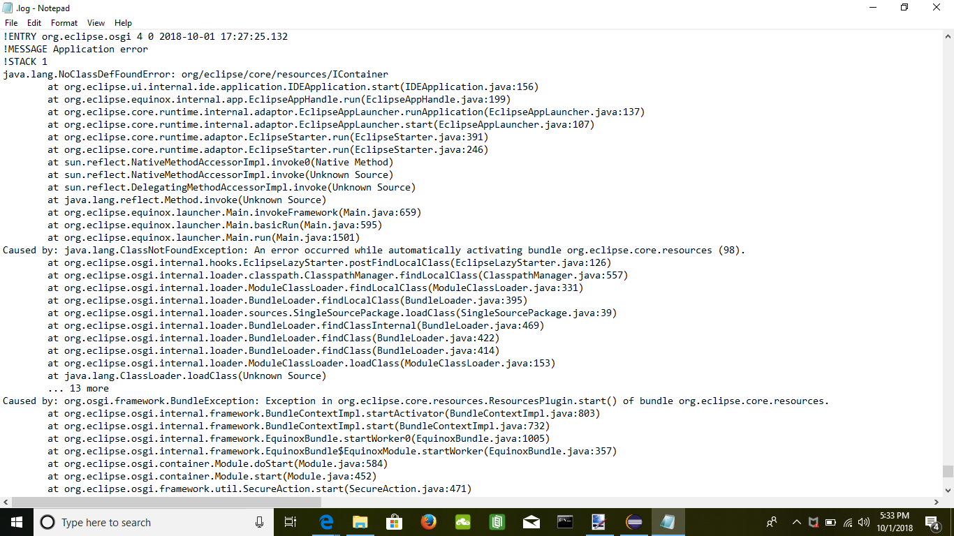

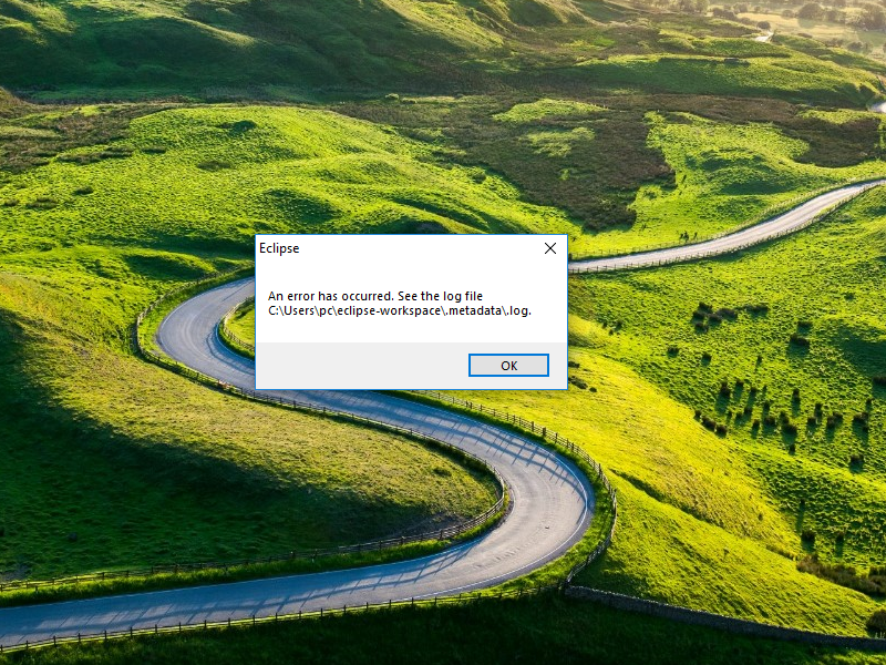

Downloaded Eclipse yesterday and it worked fine all day. I restart my computer today and try to open eclipse but I get an error. can anyone help me?index.php/fa/33985/0/

Re: Start up error [message #1795891 is a reply to message #1795887] Mon, 01 October 2018 23:07 Go to previous messageGo to next message
Do you have any technical details you can share, like how you installed Eclipse, which version it is,
where it was installed, or what version of Java you're running? Right now this looks like
an old version of Eclipse with a very new version of Java, but that's a total guess.

Re: Start up error [message #1795954 is a reply to message #1795953] Tue, 02 October 2018 21:04 Go to previous messageGo to next message
Can you post the .log file itself? Posting log files
as an image is very limiting.
Re: Start up error [message #1796087 is a reply to message #1795954] Thu, 04 October 2018 23:28 Go to previous messageGo to next message
Yes I can ill have it up shortly, ill try to boot the program and post a new log.

!ENTRY org.eclipse.osgi 4 0 2018-10-01 16:55:12.503
!MESSAGE Application error
!STACK 1
java.lang.NoClassDefFoundError: org/eclipse/core/resources/IContainer
at org.eclipse.ui.internal.ide.application.IDEApplication.start(IDEApplication.java:156)
at org.eclipse.equinox.internal.app.EclipseAppHandle.run(EclipseAppHandle.java:199)
at org.eclipse.core.runtime.internal.adaptor.EclipseAppLauncher.runApplication(EclipseAppLauncher.java:137)
at org.eclipse.core.runtime.internal.adaptor.EclipseAppLauncher.start(EclipseAppLauncher.java:107)
at org.eclipse.core.runtime.adaptor.EclipseStarter.run(EclipseStarter.java:391)
at org.eclipse.core.runtime.adaptor.EclipseStarter.run(EclipseStarter.java:246)
at org.eclipse.equinox.launcher.Main.invokeFramework(Main.java:659)
at org.eclipse.equinox.launcher.Main.basicRun(Main.java:595)
at org.eclipse.equinox.launcher.Main.run(Main.java:1501)
Caused by: java.lang.ClassNotFoundException: An error occurred while automatically activating bundle org.eclipse.core.resources (98).
at org.eclipse.osgi.internal.hooks.EclipseLazyStarter.postFindLocalClass(EclipseLazyStarter.java:126)
at org.eclipse.osgi.internal.loader.classpath.ClasspathManager.findLocalClass(ClasspathManager.java:557)
at org.eclipse.osgi.internal.loader.ModuleClassLoader.findLocalClass(ModuleClassLoader.java:331)
at org.eclipse.osgi.internal.loader.BundleLoader.findLocalClass(BundleLoader.java:395)
at org.eclipse.osgi.internal.loader.sources.SingleSourcePackage.loadClass(SingleSourcePackage.java:39)
at org.eclipse.osgi.internal.loader.BundleLoader.findClassInternal(BundleLoader.java:469)
at org.eclipse.osgi.internal.loader.BundleLoader.findClass(BundleLoader.java:422)
at org.eclipse.osgi.internal.loader.BundleLoader.findClass(BundleLoader.java:414)
at org.eclipse.osgi.internal.loader.ModuleClassLoader.loadClass(ModuleClassLoader.java:153)
... 13 more
Caused by: org.osgi.framework.BundleException: Exception in org.eclipse.core.resources.ResourcesPlugin.start() of bundle org.eclipse.core.resources.
at org.eclipse.osgi.internal.framework.BundleContextImpl.startActivator(BundleContextImpl.java:803)
at org.eclipse.osgi.internal.framework.BundleContextImpl.start(BundleContextImpl.java:732)
at org.eclipse.osgi.internal.framework.EquinoxBundle.startWorker0(EquinoxBundle.java:1005)
at org.eclipse.osgi.internal.framework.EquinoxBundle$EquinoxModule.startWorker(EquinoxBundle.java:357)
at org.eclipse.osgi.container.Module.doStart(Module.java:584)
at org.eclipse.osgi.container.Module.start(Module.java:452)
at org.eclipse.osgi.framework.util.SecureAction.start(SecureAction.java:471)
at org.eclipse.osgi.internal.hooks.EclipseLazyStarter.postFindLocalClass(EclipseLazyStarter.java:117)
... 22 more
Caused by: org.eclipse.core.internal.resources.ResourceException: Incompatible file format. Workspace was saved with an incompatible version: 0.
at org.eclipse.core.internal.resources.WorkspaceTreeReader.getReader(WorkspaceTreeReader.java:62)
at org.eclipse.core.internal.resources.WorkspaceTreeReader.getReader(WorkspaceTreeReader.java:70)
at org.eclipse.core.internal.resources.SaveManager.restoreTree(SaveManager.java:1042)
at org.eclipse.core.internal.resources.SaveManager.restore(SaveManager.java:705)
at org.eclipse.core.internal.resources.SaveManager.startup(SaveManager.java:1561)
at org.eclipse.core.internal.resources.Workspace.startup(Workspace.java:2451)
at org.eclipse.core.internal.resources.Workspace.open(Workspace.java:2208)
at org.eclipse.core.resources.ResourcesPlugin.start(ResourcesPlugin.java:489)
at org.eclipse.osgi.internal.framework.BundleContextImpl$3.run(BundleContextImpl.java:782)
at org.eclipse.osgi.internal.framework.BundleContextImpl$3.run(BundleContextImpl.java:1)
at org.eclipse.osgi.internal.framework.BundleContextImpl.startActivator(BundleContextImpl.java:775)
... 29 more
Caused by: java.lang.Exception: Incompatible file format. Workspace was saved with an incompatible version: 0.
at org.eclipse.core.internal.resources.ResourceException.provideStackTrace(ResourceException.java:42)
at org.eclipse.core.internal.resources.ResourceException.<init>(ResourceException.java:38)
... 41 more
... 22 more
... 29 more
... 41 more
!SESSION 2018-10-01 16:58:34.407 -----------------------------------------------
eclipse.buildId=4.9.0.I20180906-0745
java.version=1.8.0_192-ea
BootLoader constants: OS=win32, ARCH=x86_64, WS=win32, NL=en_US
Framework arguments: -product org.eclipse.epp.package.java.product
Command-line arguments: -os win32 -ws win32 -arch x86_64 -product org.eclipse.epp.package.java.product
!ENTRY org.eclipse.osgi 4 0 2018-10-01 16:58:43.397
!MESSAGE An error occurred while automatically activating bundle org.eclipse.core.resources (98).
!STACK 0
... 29 more
... 41 more
Root exception:
org.eclipse.core.internal.resources.ResourceException(null)[567]: java.lang.Exception: Incompatible file format. Workspace was saved with an incompatible version: 0.
!ENTRY org.eclipse.osgi 4 0 2018-10-01 16:58:43.493
!STACK 1
... 13 more
... 22 more
... 29 more
... 41 more
!SESSION 2018-10-01 17:03:13.868 -----------------------------------------------
!ENTRY org.eclipse.osgi 4 0 2018-10-01 17:04:11.040
!STACK 0
Re: Start up error [message #1796090 is a reply to message #1796088] Thu, 04 October 2018 23:45 Go to previous messageGo to next message
I also cannot uninstall at all. the program isn't even on the list of programs.
Re: Start up error [message #1796099 is a reply to message #1796090] Fri, 05 October 2018 02:19 Go to previous messageGo to next message
It looks like there is something wrong with the workspace that you're trying to open. Use the initial workspace dialog to point at a fresh new workspace location instead of an apparently corrupt/bad existing workspace location.
Re: Start up error [message #1796104 is a reply to message #1796099] Fri, 05 October 2018 03:44 Go to previous message
Omg Thank You so much its working now, I appreciate your assistance.
