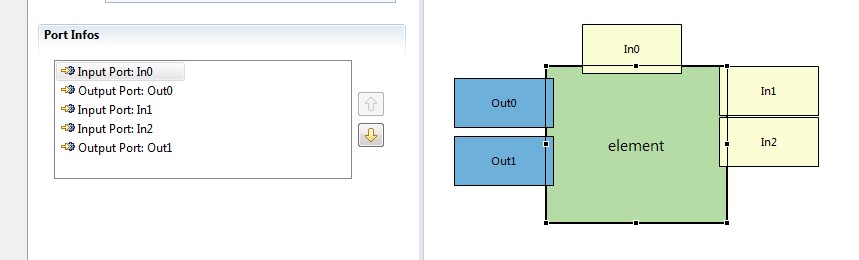

I bumpled into situation that I don't know how to deal with.
I got a diagram model which has an element with some amount of in ports and out ports.
Please, see the picture element_with_ports_and_table.jpg.
As well on picture I have properties view where I got a table "Port Infos" of this ports. Ports are shown at the table in order of adding on the element.
This part of model in xml looks like this (ports order - In0, Out0, In1, In2, Out1):

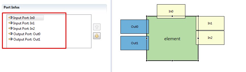

but If I move ports in table "Port Infos" by arrows like in picture changed_order_in_the_table.jpg,
the diagram does not get "dirty state", so it does not affect model xml to get order I need and keeps an old one order (In0, Out0, In1, In2, Out1),
but not a new one (In0, In1, In2, Out0, Out1) like I set in table by moving ports (changed_order_in_the_table.jpg).
If I only change the element name, then model xml is affected by order changes from the table, but I would like to get it without additional actions like change the name or something.

Hi Roman,
Only list elements in container list are ordered according to the order in the semantic model. As border nodes (ports) might be moved by the end user without affecting the semantic model, there is no synchronization between the port order and the semantic model order. The only possible restriction from the odesign is the port authorized side (see https://www.eclipse.org/sirius/doc/specifier/diagrams/Diagrams.html#authorizedsides).
Florian
