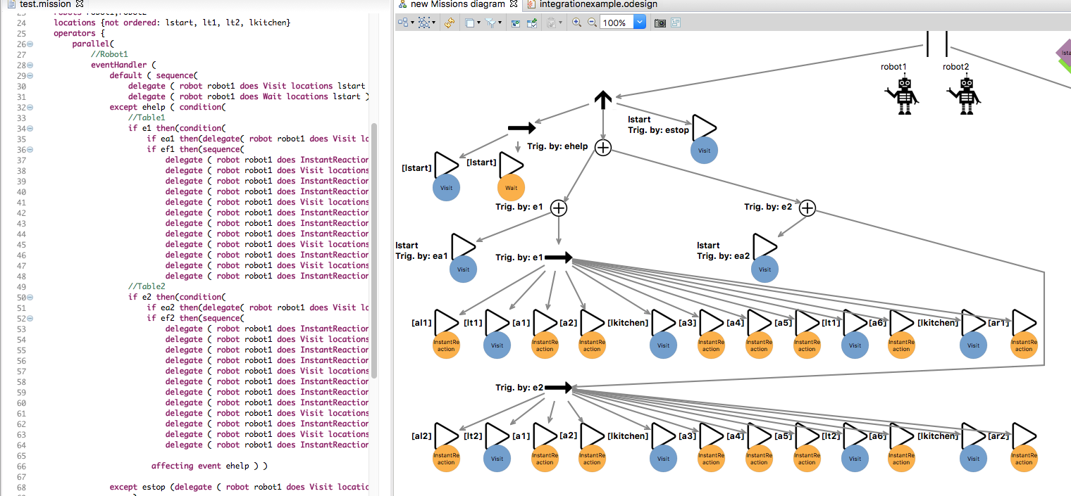

Hi!
So I developed a representation of a DSL with Sirius. The idea is to relate nodes on a behavior tree-style in ordered sets. When working with Xtext is easy to realize the order of the items (obviously) but I have no way of realizing it with the graphical syntax. I'm wondering if there's a way of getting the index of each list item and display it in its label. I'm attaching a screenshot to help you understand my idea.
Tell me if you need more info from me.
Best,
Sergio
Re: Ordered list [message #1794990 is a reply to message #1794847] Wed, 12 September 2018 05:33 Go to previous messageGo to next message
Hi Sergio,
I suggest you to create a Java service that will retrieve the index of the element and to call it from your label expression in the odesign. You will find a sample here : org.eclipse.sirius.sample.ecore.design
Florian
Re: Ordered list [message #1795163 is a reply to message #1794990] Mon, 17 September 2018 09:25 Go to previous messageGo to next message
OK, thanks. The link doesn't work, but I guess you mean something like: https://wiki.eclipse.org/Sirius/Tutorials/AdvancedTutorial#Java_Services
I'll try it and come back with the outcome :)
[SOLVED] Ordered list [message #1796359 is a reply to message #1795163] Thu, 11 October 2018 11:11 Go to previous message
It worked, thanks!
