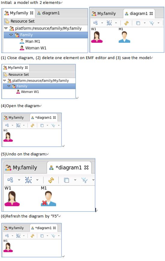

I have a model with 2 elements,
Step 1: Create a sirius diagram of the model, the diagram show the 2 elements.
Step 2: Save the diagram and close it.
Step 3: Delete one element on EMF editor, and save the model.
Step 4: Open the sirius diagram, the diagram synchronized from the model, and shows the remaining element.
Step 5: Press 'Ctrl + z' on the diagram to execute undo operation. The diagram show the deleted element with a red cross flag.
My question is, is it reasonable to allow undo operation while the diagram opened?

I know the reason is that, sirius synchronize diagram from model at opening time, this may remove some diagram elements (which the back-end model element does not exist). When user trigger undo operation, sirius bring the removed diagram elements back.
I'm not wanting to forbid undo. It is nice to show a red cross flag if the element is not exist anymore, but it make user confused sometimes.

I am not sure to understand when the red cross is visible, what undo is done, and what does mean the removed element is back and what is confusing for user.

Re: Undo operation in sirius editor [message #1794748 is a reply to message #1794712] Wed, 05 September 2018 23:22 Go to previous messageGo to next message
index.php/fa/33822/0/

This is the refresh command called "Refresh diagram on opening" that is undone. If this is too much confusing for you, you can open a Sirius ticket .
What you can do though is to clear the command stack with a SessionManageListener:
Register it with SessionManager.INSTANCE.addSessionsListener(sessionManagerListener) and use the code:
