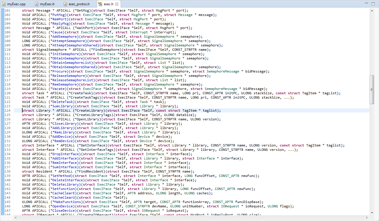

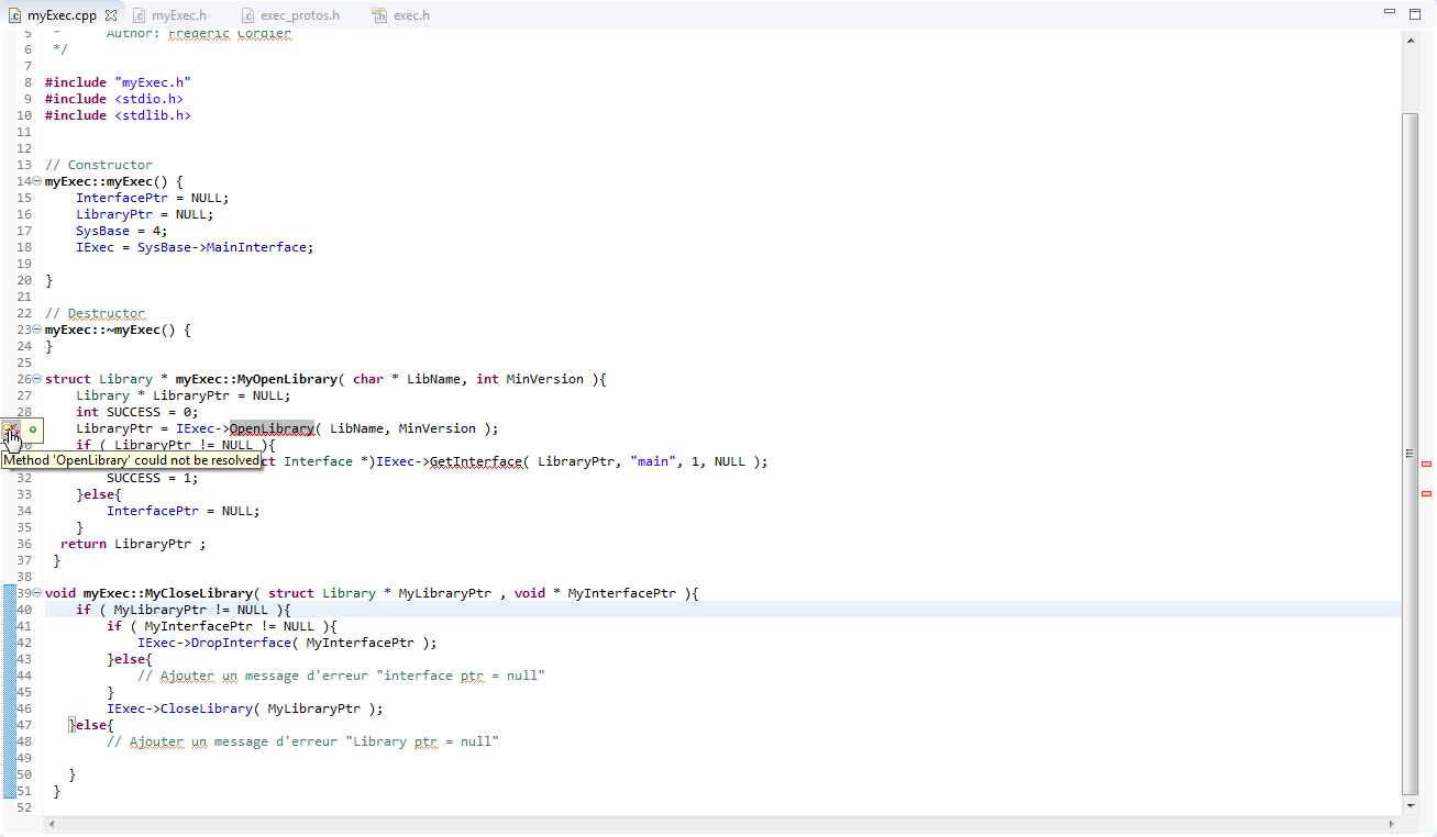

the problem concern the view.
Some AmigaOS4 SDK files are not correctly interpreted.
You can see in attachment AmigaOS4_1.png that some functions from the IExec interface are not recognized (OpenLibrary & GetInterface).
And some others (from the same Interface) are correctly handled (DropInterface & CloseLibrary ).
The file defining this interface is correctly #include(d) as some are found.
in the attachment AmigaOS4_2.png you can see part of the Interface file showing you that some functions/methods are highlighted in blue (it represent the ones that are correctly handled) and some remains in black (the ones that are not handled).
Common point of all "not handled" functions/methods, is that they returns a pointer to a specific structure.
I tried to include (at the beginning of the Interface file) the required includes to handles the appropriates structure (thinking it was an issue in the way Eclipse included files), but it didn't resolved the problem.
Does someone have any clue or an ides from where this problem may came ? Thank you.
Re: AmigaOS4 includes files uncorrectly handled [message #1795416 is a reply to message #1794554] Fri, 21 September 2018 11:02 Go to previous messageGo to next message
Hello.
No Answer ? No one have any clue if that can be some sort of setup error from myself or directly an incompatibility from Eclipse with this SDK ?

Re: AmigaOS4 includes files uncorrectly handled [message #1795816 is a reply to message #1795417] Sat, 29 September 2018 11:43 Go to previous messageGo to next message
I have no experience with the AmigaOS 4 SDK but the Indexer has a builtin Debugging Log to help you finding out issues concerning the Errors and Warnings in the IDE Editor.
Click Right on the File that has errors -> Index -> Create Parser Log File.
In the resulting file you will find out why Eclipse is so unhappy. Maybe this helps.

Re: AmigaOS4 includes files uncorrectly handled [message #1798350 is a reply to message #1796139] Thu, 15 November 2018 18:04 Go to previous messageGo to next message
Hello Andre Zeps,
The parser error reports many syntax errors (in fact it report this for each line where a library function definition is available.
Each library function definition also get the error "unresolved names".

Here is the library file that own these errors :
#ifndef EXEC_INTERFACE_DEF_H
#define EXEC_INTERFACE_DEF_H
** This file was machine generated by idltool 52.6.
** Do not edit
#ifndef EXEC_TYPES_H
#include <exec/types.h>
#endif
#ifndef EXEC_EXEC_H
#include <exec/exec.h>
#endif
#ifndef EXEC_INTERFACES_H
#include <exec/interfaces.h>
#endif
#ifndef UTILITY_UTILITY_H
#include <utility/utility.h>
#endif
#ifdef __cplusplus
#ifdef __USE_AMIGAOS_NAMESPACE__
namespace AmigaOS {
#endif
extern "C" {
#endif
#include <exec/execbase.h>
struct ExecIFace
	struct InterfaceData Data;
	ULONG APICALL (*Obtain)(struct ExecIFace *Self);
	ULONG APICALL (*Release)(struct ExecIFace *Self);
	Void APICALL (*Expunge)(struct ExecIFace *Self);
	struct Interface * APICALL (*Clone)(struct ExecIFace *Self);
	Void APICALL (*AddHead)(struct ExecIFace *Self, struct List * list, struct Node * node);
	Void APICALL (*AddMemHandler)(struct ExecIFace *Self, struct Interrupt * memHandler);
	Void APICALL (*AddMemList)(struct ExecIFace *Self, ULONG size, ULONG attributes, LONG pri, APTR base, CONST_STRPTR name);
	Void APICALL (*AddTail)(struct ExecIFace *Self, struct List * list, struct Node * node);
	APTR APICALL (*AllocAbs)(struct ExecIFace *Self, ULONG byteSize, APTR location);
	APTR APICALL (*Allocate)(struct ExecIFace *Self, struct MemHeader * memHeader, ULONG byteSize);
	struct MemList * APICALL (*AllocEntry)(struct ExecIFace *Self, struct MemList * memList);
	APTR APICALL (*AllocMem)(struct ExecIFace *Self, ULONG byteSize, ULONG attributes);
	APTR APICALL (*AllocPooled)(struct ExecIFace *Self, APTR poolHeader, ULONG memSize);
	APTR APICALL (*AllocVec)(struct ExecIFace *Self, ULONG byteSize, ULONG attributes);
	APTR APICALL (*AllocVecPooled)(struct ExecIFace *Self, APTR poolHeader, ULONG size);
	ULONG APICALL (*AvailMem)(struct ExecIFace *Self, ULONG attributes);
	Void APICALL (*CopyMem)(struct ExecIFace *Self, CONST_APTR source, APTR dest, ULONG size);
	Void APICALL (*CopyMemQuick)(struct ExecIFace *Self, CONST_APTR source, APTR dest, ULONG size);
	APTR APICALL (*CreatePool)(struct ExecIFace *Self, ULONG memFlags, ULONG puddleSize, ULONG threshSize);
	Void APICALL (*Deallocate)(struct ExecIFace *Self, struct MemHeader * memHeader, APTR memoryBlock, ULONG byteSize);
	Void APICALL (*DeletePool)(struct ExecIFace *Self, APTR poolHeader);
	Void APICALL (*Enqueue)(struct ExecIFace *Self, struct List * list, struct Node * node);
	struct Node * APICALL (*FindName)(struct ExecIFace *Self, struct List * start, CONST_STRPTR name);
	struct Node * APICALL (*FindIName)(struct ExecIFace *Self, struct List * start, CONST_STRPTR name);
	Void APICALL (*Forbid)(struct ExecIFace *Self);
	Void APICALL (*FreeEntry)(struct ExecIFace *Self, struct MemList * memList);
	Void APICALL (*FreeMem)(struct ExecIFace *Self, APTR memoryBlock, ULONG byteSize);
	Void APICALL (*FreePooled)(struct ExecIFace *Self, APTR poolHeader, APTR memory, ULONG memSize);
	Void APICALL (*FreeVec)(struct ExecIFace *Self, APTR memoryBlock);
	Void APICALL (*FreeVecPooled)(struct ExecIFace *Self, APTR poolHeader, APTR memory);
	Void APICALL (*InitData)(struct ExecIFace *Self, CONST_APTR initTab, APTR memory, ULONG size);
	Void APICALL (*InitStruct)(struct ExecIFace *Self, CONST_APTR initTable, APTR memory, ULONG size);
	Void APICALL (*Insert)(struct ExecIFace *Self, struct List * list, struct Node * node, struct Node * listNode);
	struct Interface * APICALL (*MakeInterface)(struct ExecIFace *Self, struct Library * library, const struct TagItem * taglist);
	struct Interface * APICALL (*MakeInterfaceTags)(struct ExecIFace *Self, struct Library * library, ...);
	Void APICALL (*Permit)(struct ExecIFace *Self);
	APTR APICALL (*RawDoFmt)(struct ExecIFace *Self, CONST_STRPTR formatString, CONST_APTR dataStream, Void (*PutChProc)(), APTR PutChData);
	struct Node * APICALL (*RemHead)(struct ExecIFace *Self, struct List * list);
	Void APICALL (*RemMemHandler)(struct ExecIFace *Self, struct Interrupt * memHandler);
	Void APICALL (*Remove)(struct ExecIFace *Self, struct Node * node);
	struct Node * APICALL (*RemTail)(struct ExecIFace *Self, struct List * list);
	ULONG APICALL (*TypeOfMem)(struct ExecIFace *Self, CONST_APTR address);
	APTR APICALL (*InitResident)(struct ExecIFace *Self, const struct Resident * resident, ULONG segList);
	Void APICALL (*InitCode)(struct ExecIFace *Self, ULONG startClass, ULONG version);
	ULONG APICALL (*SumKickData)(struct ExecIFace *Self);
	APTR APICALL (*AddTask)(struct ExecIFace *Self, struct Task * task, CONST_APTR initialPC, CONST_APTR finalPC, const struct TagItem * tagList);
	APTR APICALL (*AddTaskTags)(struct ExecIFace *Self, struct Task * task, CONST_APTR initialPC, CONST_APTR finalPC, ...);
	Void APICALL (*Disable)(struct ExecIFace *Self);
	Void APICALL (*Enable)(struct ExecIFace *Self);
	APTR Private1;
	struct Task * APICALL (*FindTask)(struct ExecIFace *Self, CONST_STRPTR name);
	Void APICALL (*RemTask)(struct ExecIFace *Self, struct Task * task);
	BYTE APICALL (*SetTaskPri)(struct ExecIFace *Self, struct Task * task, BYTE priority);
	Void APICALL (*StackSwap)(struct ExecIFace *Self, struct StackSwapStruct * newstack);
	BYTE APICALL (*AllocSignal)(struct ExecIFace *Self, BYTE signalNum);
	Void APICALL (*FreeSignal)(struct ExecIFace *Self, BYTE signalNum);
	ULONG APICALL (*SetExcept)(struct ExecIFace *Self, ULONG newSignals, ULONG signalMask);
	ULONG APICALL (*SetSignal)(struct ExecIFace *Self, ULONG newSignals, ULONG signalMask);
	Void APICALL (*Signal)(struct ExecIFace *Self, struct Task * task, ULONG signals);
	ULONG APICALL (*Wait)(struct ExecIFace *Self, ULONG signalSet);
	Void APICALL (*AddPort)(struct ExecIFace *Self, struct MsgPort * port);
	struct MsgPort * APICALL (*CreatePort)(struct ExecIFace *Self, CONST_STRPTR name, BYTE pri);
	struct MsgPort * APICALL (*CreateMsgPort)(struct ExecIFace *Self);
	Void APICALL (*DeletePort)(struct ExecIFace *Self, struct MsgPort * port);
	Void APICALL (*DeleteMsgPort)(struct ExecIFace *Self, struct MsgPort * port);
	struct MsgPort * APICALL (*FindPort)(struct ExecIFace *Self, CONST_STRPTR name);
	struct Message * APICALL (*GetMsg)(struct ExecIFace *Self, struct MsgPort * port);
	Void APICALL (*PutMsg)(struct ExecIFace *Self, struct MsgPort * port, struct Message * message);
	Void APICALL (*RemPort)(struct ExecIFace *Self, struct MsgPort * port);
	Void APICALL (*ReplyMsg)(struct ExecIFace *Self, struct Message * message);
	struct Message * APICALL (*WaitPort)(struct ExecIFace *Self, struct MsgPort * port);
	Void APICALL (*Cause)(struct ExecIFace *Self, struct Interrupt * interrupt);
	Void APICALL (*AddSemaphore)(struct ExecIFace *Self, struct SignalSemaphore * semaphore);
	LONG APICALL (*AttemptSemaphore)(struct ExecIFace *Self, struct SignalSemaphore * semaphore);
	LONG APICALL (*AttemptSemaphoreShared)(struct ExecIFace *Self, struct SignalSemaphore * semaphore);
	struct SignalSemaphore * APICALL (*FindSemaphore)(struct ExecIFace *Self, CONST_STRPTR name);
	Void APICALL (*InitSemaphore)(struct ExecIFace *Self, struct SignalSemaphore * semaphore);
	Void APICALL (*ObtainSemaphore)(struct ExecIFace *Self, struct SignalSemaphore * semaphore);
	Void APICALL (*ObtainSemaphoreList)(struct ExecIFace *Self, struct List * list);
	Void APICALL (*ObtainSemaphoreShared)(struct ExecIFace *Self, struct SignalSemaphore * semaphore);
	Void APICALL (*Procure)(struct ExecIFace *Self, struct SignalSemaphore * semaphore, struct SemaphoreMessage * bidMessage);
	Void APICALL (*ReleaseSemaphore)(struct ExecIFace *Self, struct SignalSemaphore * semaphore);
	Void APICALL (*ReleaseSemaphoreList)(struct ExecIFace *Self, struct List * list);
	Void APICALL (*RemSemaphore)(struct ExecIFace *Self, struct SignalSemaphore * semaphore);
	Void APICALL (*Vacate)(struct ExecIFace *Self, struct SignalSemaphore * semaphore, struct SemaphoreMessage * bidMessage);
	struct Task * APICALL (*CreateTask)(struct ExecIFace *Self, CONST_STRPTR name, LONG pri, CONST_APTR initPC, ULONG stackSize, const struct TagItem * tagList);
	struct Task * APICALL (*CreateTaskTags)(struct ExecIFace *Self, CONST_STRPTR name, LONG pri, CONST_APTR initPC, ULONG stackSize, ...);
	Void APICALL (*DeleteTask)(struct ExecIFace *Self, struct Task * task);
	Void APICALL (*SumLibrary)(struct ExecIFace *Self, struct Library * library);
	struct Library * APICALL (*CreateLibrary)(struct ExecIFace *Self, const struct TagItem * taglist);
	struct Library * APICALL (*CreateLibraryTags)(struct ExecIFace *Self, ULONG dataSize);
	struct Library * APICALL (*OpenLibrary)(Struct ExecIFace *Self, CONST_STRPTR name, ULONG version);
	APTR APICALL (*CloseLibrary)(struct ExecIFace *Self, struct Library * library);
	Void APICALL (*AddLibrary)(struct ExecIFace *Self, struct Library * library);
	ULONG APICALL (*RemLibrary)(struct ExecIFace *Self, struct Library * library);
	Void APICALL (*AddDevice)(struct ExecIFace *Self, struct Device * device);
	ULONG APICALL (*RemDevice)(struct ExecIFace *Self, struct Device * device);
	struct Interface * APICALL (*GetInterface)(struct ExecIFace *Self, struct Library * library, CONST_STRPTR name, ULONG version, const struct TagItem * taglist);
	struct Interface * APICALL (*GetInterfaceTags)(struct ExecIFace *Self, struct Library * library, CONST_STRPTR name, ULONG version, ...);
	Void APICALL (*DropInterface)(struct ExecIFace *Self, struct Interface * interface);
	Void APICALL (*AddInterface)(struct ExecIFace *Self, struct Library * library, struct Interface * interface);
	Void APICALL (*RemInterface)(struct ExecIFace *Self, struct Interface * interface);
	Void APICALL (*SumInterface)(struct ExecIFace *Self, struct Interface * interface);
	struct Resident * APICALL (*FindResident)(struct ExecIFace *Self, CONST_STRPTR name);
	APTR APICALL (*SetMethod)(struct ExecIFace *Self, struct Interface * interface, LONG funcOffset, CONST_APTR newFunc);
	Void APICALL (*DeleteInterface)(struct ExecIFace *Self, struct Interface * interface);
	Void APICALL (*DeleteLibrary)(struct ExecIFace *Self, struct Library * library);
	APTR APICALL (*SetFunction)(struct ExecIFace *Self, struct Library * library, LONG funcOffset, CONST_APTR newFunc);
	Void APICALL (*CacheClearE)(struct ExecIFace *Self, APTR address, ULONG length, ULONG caches);
	Void APICALL (*CacheClearU)(struct ExecIFace *Self);
	ULONG APICALL (*MakeFunctions)(struct ExecIFace *Self, APTR target, CONST_APTR functionArray, CONST_APTR funcDispBase);
	LONG APICALL (*OpenDevice)(struct ExecIFace *Self, CONST_STRPTR devName, ULONG unitNumber, struct IORequest * ioRequest, ULONG flags);
	APTR APICALL (*CloseDevice)(struct ExecIFace *Self, struct IORequest * ioRequest);
	struct IORequest * APICALL (*CreateIORequest)(struct ExecIFace *Self, const struct MsgPort * ioReplyPort, ULONG size);
	Void APICALL (*DeleteIORequest)(struct ExecIFace *Self, struct IORequest * ioRequest);
	Void APICALL (*AbortIO)(struct ExecIFace *Self, struct IORequest * ioRequest);
	struct IORequest * APICALL (*CheckIO)(struct ExecIFace *Self, struct IORequest * ioRequest);
	BYTE APICALL (*DoIO)(struct ExecIFace *Self, struct IORequest * ioRequest);

Re: AmigaOS4 includes files uncorrectly handled [message #1798359 is a reply to message #1798351] Fri, 16 November 2018 02:20 Go to previous messageGo to next message
You don't see these as big hints?
Syntax error in file: D:\Development\Amiga\Compilers\ppc-amigaos\SDK\Include\include_h\interfaces\exec.h:35
Attempt to use symbol failed: APICALL in file D:\Development\Amiga\Compilers\ppc-amigaos\SDK\Include\include_h\interfaces\exec.h:35
[presumably exec.h:35] ULONG APICALL (*Obtain)(struct ExecIFace *Self);
APICALL doesn't appear in the list of defined macros.
So where is it supposed to be defined and why wasn't it?
For that matter and for what it's worth, neither is __USE_AMIGAOS_NAMESPACE__
[Updated on: Fri, 16 November 2018 02:54] by Moderator
Re: AmigaOS4 includes files uncorrectly handled [message #1798363 is a reply to message #1798359] Fri, 16 November 2018 03:18 Go to previous messageGo to next message
Hello David Vavra.
I supposed that APICALL was some sort of "generic" system.
I will hunt in my SDK files to see where the APICALL is defined and then what I should manually includes to makes it work.
But with this reporter parser issue, there is 1 question available.
Why some of the methods are correctly handled and some not ?
Thank you for your answer it will help me .
Re: AmigaOS4 includes files uncorrectly handled [message #1798373 is a reply to message #1798363] Fri, 16 November 2018 05:03 Go to previous messageGo to next message
Presumably, wherever it is defined is supposed to have been included prior to compiling with exec.h.
This is a machine generated file according to the comments.
If you really can't modify it to include all necessary files, you can have the Indexer do it when editing.
    o) Project --> Properties --> C/C++ General --> Preprocessor Include Paths, Macros, etc. --> Entries tab --> CDT User Settings Entries --> Add
    o) Select Include file in the drop down and fill out the rest of the dialog to specify the file.
    o) You need to do this for each language ( C and C++) you are using.
    o) The settings are specific to build configurations but you can select All Configurations.
    o) You may need to move the CDT User Settings Entries after the CDT GCC Build Settings Entries
    o) NOTE: the Indexer doesn't handle multiple definitions well. If the definitions are different for each language, you may need to force *.h files to be treated as the predominant one. Project --> Properties --> C/C++ General --> File types. You can try manually setting some definitions (__cplusplus, e.g.) before the included file in CDT User Settings Entries but the Indexer still needs to know the language to use for *.h files.
Then the Indexer will know what the extra definitions are.
Otherwise, the Indexer will only remember the definitions in the files you have edited.
[Updated on: Fri, 16 November 2018 05:51] by Moderator
Re: AmigaOS4 includes files uncorrectly handled [message #1798777 is a reply to message #1798373] Sat, 24 November 2018 03:34 Go to previous messageGo to next message
Hello all and thank you for your help.
Now the errors occured in the .exec file are fewer.
I fixed all the ones reported in the prvious log files by including (at the beginning of the file) the file that define the APICALL.
I also fixed referencies to "Void" that should be "void" (lower case). I now have only 6 errors. 1 Parser problem and 6 unresolved names I will try to fix.
Here is the current log file :

The parser problem is the only error I don't understand.
It occured on that line :
for the other ones I will find the files to includes.
Thank you
Re: AmigaOS4 includes files uncorrectly handled [message #1798778 is a reply to message #1798777] Sat, 24 November 2018 05:34 Go to previous messageGo to next message
The following works:
#define APICALL
typedef string const * CONST_STRPTR;
typedef unsigned long ULONG;
struct Library * APICALL (*OpenLibrary)(struct ExecIFace *Self, CONST_STRPTR name, ULONG version);
but something like the following doesn't:
#define APICALL
#define CONST_STRPTR string const * ; // <--- semicolon bad
Nor does (Note the StructExecIFace instead of structExecIFace ):
#define APICALL
In any case. it's not the Indexer causing the problem.
More than likely you are inserting the syntax error.
The best way to track it down is to simplify the code as I've done above.
[Updated on: Sat, 24 November 2018 05:35] by Moderator
Re: AmigaOS4 includes files uncorrectly handled [message #1798786 is a reply to message #1798778] Sat, 24 November 2018 14:52 Go to previous messageGo to next message
Hello David and once again, thank you for your help.
As I'm not the author of this SDK ( It's http://www.hyperion-entertainment.biz , the developer of Amiga OS 4 ) I didn't checked all files for compatibility with general C/C++ compilers/preprocessors.
When I use this SDK directly from a computer running AmigaOS4, I did encounter no problem with this SDK, but now I understand that there are probably many *uncorrect* way of working available in this SDK that are compatible with GCC but not on more "precise" tools.
in a file called types.h the CONST_STRPTR is defined this way :
#if (defined(__GNUC__) && defined(__CHAR_UNSIGNED__)) || (defined(__SASC) && defined(_UNSCHAR))
typedef CONST          char * CONST_STRPTR; /* STRPTR to const TEXT */
#else
typedef CONST unsigned char * CONST_STRPTR; /* STRPTR to const TEXT */
#endif
I will make changes to test if it works how you said.
[Updated on: Sat, 24 November 2018 15:10] by Moderator
Re: AmigaOS4 includes files uncorrectly handled [message #1798787 is a reply to message #1798786] Sat, 24 November 2018 15:44 Go to previous message
I've made some changes :
New Version :
	typedef char const * CONST_STRPTR; /* STRPTR to const TEXT */
#else
	typedef unsigned char const * CONST_STRPTR; /* STRPTR to const TEXT */
#endif
And this code works :)
Now, I must fix the other dependencies.
Theses dependencies have error (parser error). I've noticed that another define can't be resolved.
I've checked the file where the define are set (and that is already included as it was the one where some others I've fixed were).
Errors pointed now to thse lines :
typedef LONG (* ASM AVLNODECOMP)(REG(n, struct AVLNode *avlnode1), REG(a1, struct AVLNode *avlnode2));
typedef LONG (* ASM AVLKEYCOMP)(REG(a0, struct AVLNode *avlnode1), REG(a1, AVLKey avlkey));
I've checked ASM, REG, AVLNODE & AVLKey . All seem ok.
AVLNODE & AVLKey are defined upper in the file with this that seem correct :
/* Don't even think about the contents of this structure. Just embed it
   and reference it */
struct AVLNode
    ULONG reserved[4];
/* Note that this is really a totally abstract 32 bit value */
typedef void * AVLKey;
If I include ASM & REG
#ifndef ASM
#define ASM __asm
#endif
#ifndef REG
#define REG(reg,arg) arg
#endif
Same Issue.
I just have a1 & a0 to find and check.
