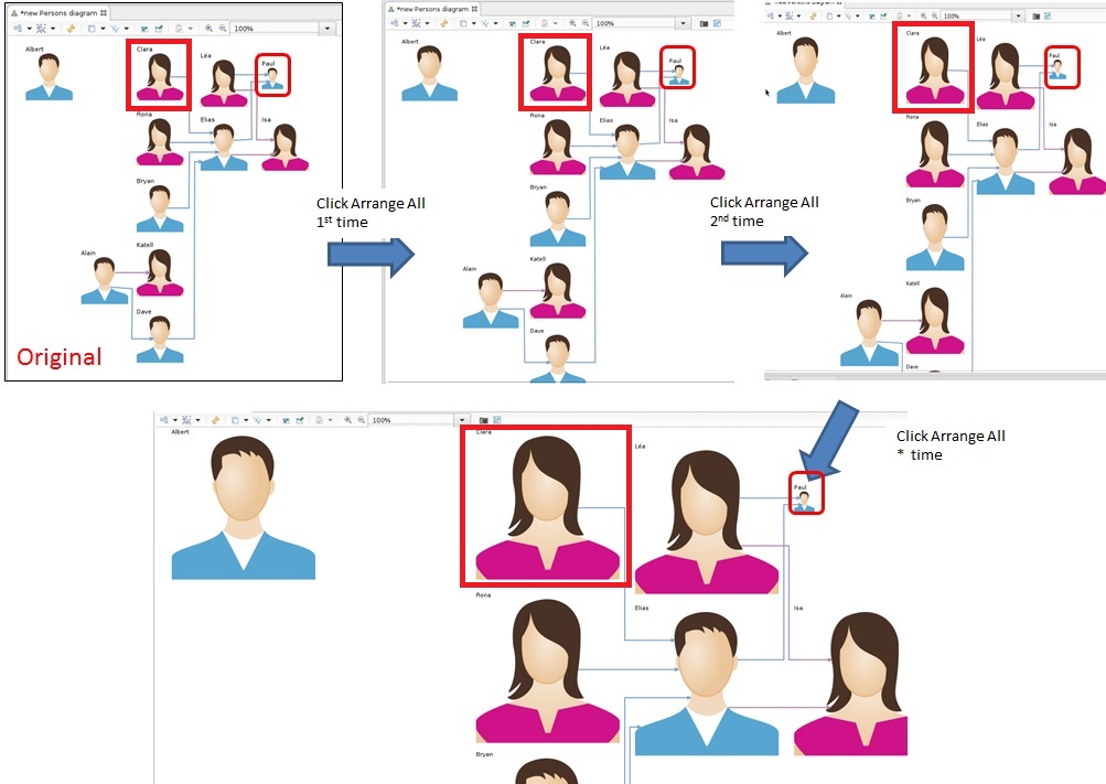

When I use Sirius 6.0, which has integrated ELK function.
I use the family example, and give the diagram layout function is 'ELK Layered', without any specific global option.
I found a problem, if I click the 'Arrange All' button multi-time, the diagram element size will be bigger in every time.
You can see after several 'Arrange All', Clara is bigger than 1st time.
But, you can see the Paul, who is in the top right corner, does not change the size.
index.php/fa/33798/0/
This problem not only shown Sirius(6.0) & ELK(0.3), but also shown Sirius(4.1.3) & ELK(0.2.2), so I think this problem may a defect of Sirius & ELK integration.
I attach the metamodel and model, and create a defect in Sirius Bugzilla.

Thank you for your clean and detailed bugzilla. I was able to reproduce.
For information Sirius 4.1.3 has no ELK integration so I guess you were using the GMF connector provided by ELK. And because we reuse most of the code of this connector in our own I think this is why you had the problem in both version.
