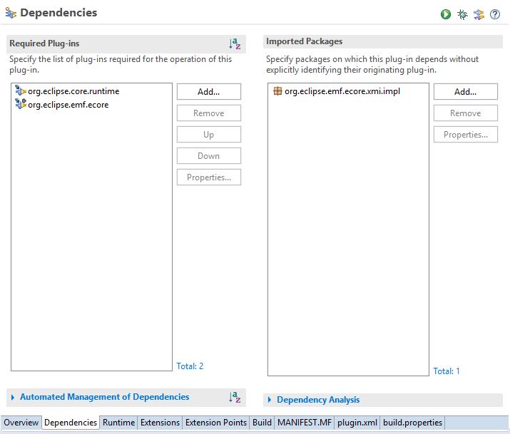

I have tried using the Manifest.Mf already present in the project, but I get the same error.
The dependencies window clearly show that emf.ecore is a required plug-in.
(see attachment 1)
Below is the full Manifest text, the Require-Bundle shows emf.ecore.

Re: NoClassDefFoundError while launching jar in command line [message #1794172 is a reply to message #1794168] Sat, 25 August 2018 01:21 Go to previous message
You need to use Run As->Java Application to get the classpath built for you.
(The next version of Eclipse, via [1], should enable you to use the automatically created launch configuration to give you a command line that you can cut and paste into a naked OS command line.).
