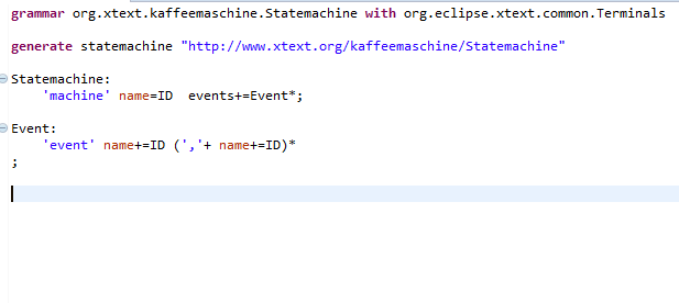

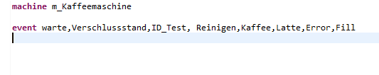

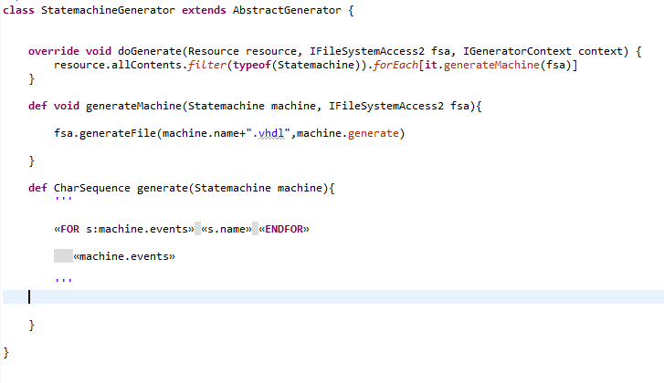

are you sure events is not a list of lists? that would explain the [] in your output
Re: Acces a single element in a list of events [message #1793786 is a reply to message #1793785] Wed, 15 August 2018 15:46 Go to previous messageGo to next message
Exactly I got abit irritated when I saw the braces"[ ]". Well I just uploaded the pictures of what im doing right now. I hope with thos Info you will get my problems. Thanks again.
  • Attachment: codegen.PNG
    (Size: 14.19KB, Downloaded 84 times)
  • Attachment: test.PNG
    (Size: 3.10KB, Downloaded 114 times)
  • Attachment: gramw.PNG
    (Size: 8.13KB, Downloaded 108 times)
Re: Acces a single element in a list of events [message #1793787 is a reply to message #1793786] Wed, 15 August 2018 15:53 Go to previous messageGo to next message
in your case a event is a list of names. so you want the first name in the first event?
=> you can use
«statemachine.events.head.name.head»
maybe you should rename "name" to "names" in the grammar to make clear it is a list.
