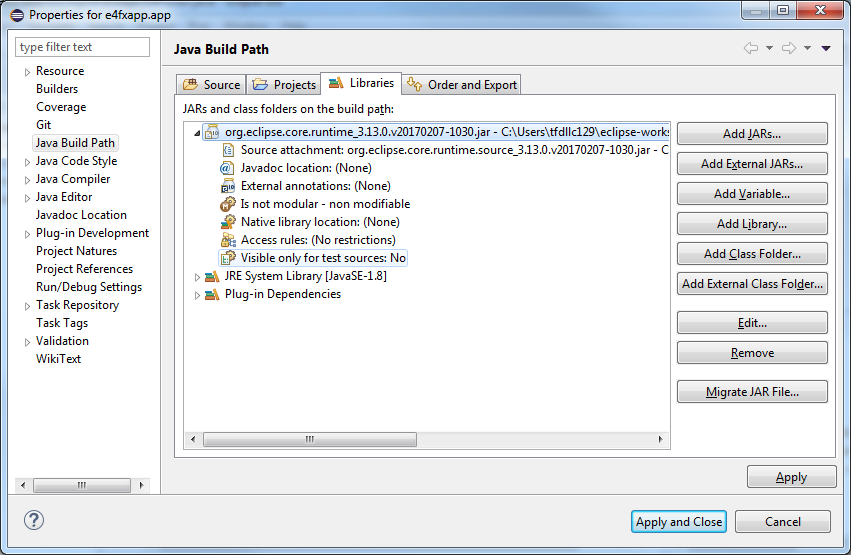

In the java editor I get "PlatformObject cannot be resolved to a type" even after Source -> Organize Imports.
I've added org.eclipse.core.runtime_3.13.0.v20170207-1030.jar to the Libraries tab of the Java Build Path dialog.
I also added org.eclipse.core.runtime.source_3.13.0.v20170207-1030.jar to the Source attachment: field of the library.
Any suggestions?

Try adding org.eclipse.equinox.common*.jar.
Re: Trying to use org.eclipse.core.runtime.PlatformObject [message #1793340 is a reply to message #1793339] Sun, 05 August 2018 19:28 Go to previous messageGo to next message
Works. Thank you.

Adding to Properties/Java Build Path/Libraries tab fails when you login with a different ID.
The better way is to add it to the MANIFEST.MF editor's Dependencies tab/ Required Plug-ins section.
