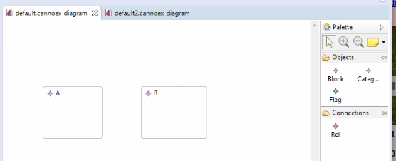

Hi Dimitris,
Thank you for your answer.
However, the steps you defined are not what I need
1. The diagram obtained is the Ecore diagram. I need a diagram for an instance of the Ecore model.
2. I need a diagram editor with the diagram, not just the diagram
3. I need the steps to do this task programatically (i.e. using code) since the end goal is to have a script take an instance and make it into an Eugenia graph editor
Let me try to specify what I need
Suppose the Ecore Diagram given in attachment 1
I then have a file with the following content
Block A
Block B
An image of that model instance in Eclipse is shown in attachment 2
When I open the Eugenia GMF Editor, I would like to see this already there : see attachment 3
I don't want to have to make it by hand using my mouse.
Update : I have noticed that the code to make the graph seems to be in a XML file.
That file contains the following
<canNoEx:Domainmodel xmi:version="2.0" xmlns:xmi="http://www.omg.org/XMI" xmlns:xsi="http://www.w3.org/2001/XMLSchema-instance" xmlns:canNoEx="http://www.xtext.org/example/canardNoExtends/CanNoEx">
  <elements xsi:type="canNoEx:Block" name="A"/>
  <elements xsi:type="canNoEx:Block" name="B"/>
</canNoEx:Domainmodel>
I tried to test by adding
  <elements xsi:type="canNoEx:Block" name="C"/>
But the Editor did not update the Diagram

I did another test with a new project and this time, adding the C Block line worked. The diagram editor was updated!
The last step I need to do is find out how to automate all of these tasks.
To initialise a diagram for your model (My.canNoEx) you should right-click on it and select "Initialize ... diagram"
> 3. You can find the code that initialises a diagram from a model (i.e. the code behind the "Initialize ... diagram" menu item) in the generated .diagram plugin. I don't remember the name of the class off the top of my head but if you can't find it, please let me know and I'll have a look.
Cheers,
Dimitris
