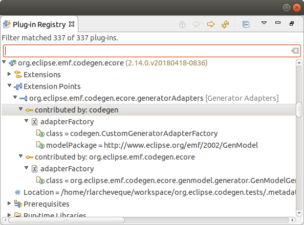

Re: Tips/Advices to change EMF code generator behaviours [message #1794355 is a reply to message #1793217] Wed, 29 August 2018 09:37 Go to previous messageGo to next message
In the past few days, I have continued development. While I was completing the javadoc and the last tests, I realized that the Import Manager has stopped working. I decided to create an example from the bottom up. After 2 days of tests of all kinds, I can no longer operate the Import Manager. It seems that the getImportedName () I overloaded no longer plays its role. Yet everything worked perfectly. I'm sure it's a detail that is missing but I cannot figure it out. Here's the main artifacts.
1) TestGeneratorAdapterFactory
public class TestGeneratorAdapterFactory extends GenModelGeneratorAdapterFactory {
	public Adapter createGenClassAdapter() {
		if (genClassGeneratorAdapter == null) {
			genClassGeneratorAdapter = new GenClassGeneratorAdapter(this) {
				protected void createImportManager(String packageName, String className) {
					importManager = new TestImportManager(packageName);
					importManager.addMasterImport(packageName, className);
					if (generatingObject != null) {
						((GenBase) generatingObject).getGenModel().setImportManager(importManager);
		return genClassGeneratorAdapter;
	public Adapter createGenPackageAdapter() {
		if (genPackageGeneratorAdapter == null) {
			genPackageGeneratorAdapter = new GenPackageGeneratorAdapter(this) {
		return genPackageGeneratorAdapter;
	public Adapter createGenModelAdapter() {
		if (genModelGeneratorAdapter == null) {
			genModelGeneratorAdapter = new GenModelGeneratorAdapter(this) {
		return genModelGeneratorAdapter;
	public class TestImportManager extends ImportManager {
		public TestImportManager(String compilationUnitPackage) {
			super(compilationUnitPackage);
		public String getImportedName(String qualifiedName, boolean autoImport) {
			if (qualifiedName.equals("test.impl.AImpl")) {
				return super.getImportedName("test.impl.ACustomImpl", autoImport);
			} else {
				return super.getImportedName(qualifiedName, autoImport);
2) test.xcore test sample
@GenModel(dynamicTemplates="false")
package test
class A{}
class B extends A{}
3) Resulting Class (AImpl should be ACustomImpl based on TestGeneratorAdapterFactory)
public class BImpl extends AImpl implements B {
	protected BImpl() {
		super();
	protected EClass eStaticClass() {
		return TestPackage.Literals.B;
} //BImpl
I put in attachment the codegen sample project (Eclipse host) and the codegen test project (Eclipse target).
Thanks in advance.
Re: Tips/Advices to change EMF code generator behaviours [message #1794356 is a reply to message #1794355] Wed, 29 August 2018 09:38 Go to previous messageGo to next message
I use Photon 4.8-SDK.
Re: Tips/Advices to change EMF code generator behaviours [message #1794359 is a reply to message #1794356] Wed, 29 August 2018 10:42 Go to previous messageGo to next message
Sorry, I won't have time to look closer today, but make sure that in org.eclipse.emf.codegen.ecore.genmodel.impl.GenModelImpl.getImportedName(String) it's really using your specialized ImportManager, and if not, find out how is calling org.eclipse.emf.codegen.ecore.genmodel.impl.GenModelImpl.setImportManager(ImportManager) with a different instance from the one you are hoping to use.
Re: Tips/Advices to change EMF code generator behaviours [message #1794362 is a reply to message #1794359] Wed, 29 August 2018 10:48 Go to previous messageGo to next message
It is really my custom ImportManager that is being called.
Thanks Ed.
Re: Tips/Advices to change EMF code generator behaviours [message #1794370 is a reply to message #1794362] Wed, 29 August 2018 12:18 Go to previous messageGo to next message
That suggests your method is being called, but not for that class name? See what's happening in org.eclipse.emf.codegen.ecore.genmodel.impl.GenClassImpl.getClassExtends(). Surely that's being called and you just suggested it's calling you specialized importer too...
Re: Tips/Advices to change EMF code generator behaviours [message #1794373 is a reply to message #1794370] Wed, 29 August 2018 12:26 Go to previous messageGo to next message
When developing the OCL code generators, I recall a few miraculous things happening / not-happening. In particular you used to be able to get the wrong JET templates. IIRC a bug was fixed for this about 6 months ago.
I recommend putting in a few debug console output statements that clearly identify which software sub-system you are using from where and when.
Ed Willink
Re: Tips/Advices to change EMF code generator behaviours [message #1794378 is a reply to message #1793217] Wed, 29 August 2018 15:23 Go to previous messageGo to next message
My colleague and pursued the investigation without any success. I modified a little the codegen to simplify the debugging. I tried different approaches in ImportManager#getImportedName(String, boolean) such as:
returnValue = super.getImportedName("test.impl.AImpl", autoImport);
returnValue = super.getImportedName("test.impl.ACustomImpl", autoImport);
shortNameToImportMap.put("AImpl", "test.impl.ACustomImpl");
addImport("test.impl.ACustomImpl");
returnValue = "ACustomImpl";
Despite the several permutations, no changes were conclusive.
IMPORTANT NOTE: At some point, and I don't know why, we noticed momentarily the proper desired change to be reflected in the target JDT editor then it switched back to the default and undesired behaviour. This happened for a while before stopping for a reason that I do not understand.
ORIGINAL: public class BImpl extends AImpl
INTERMEDIATE: public class BImpl extends ACustomImpl (change momentarily less than half a second)
FINAL: public class BImpl extends AImpl
If you generate the code for test.xcore, the custom codegen generate a log in the console. Pay attention to the last section:
TestImportManager(): Qualified Name = test.impl.BImpl, ECoreClass = B
         getImportedName(): test.impl.AImpl
[color=red]         getImportedName() === Customize the import for this one.[/color]
[color=red]         getImportedName(): test.impl.AImpl >>> ACustomImpl[/color]
         getImportedName(): test.B
         getImportedName(): test.B >>> B
         getImportedName(): org.eclipse.emf.ecore.EClass
         getImportedName(): org.eclipse.emf.ecore.EClass >>> EClass
         getImportedName(): test.TestPackage
         getImportedName(): test.TestPackage >>> TestPackage
         printMap(shortName, importName):
                  super  => BImpl.super

Re: Tips/Advices to change EMF code generator behaviours [message #1794380 is a reply to message #1794378] Wed, 29 August 2018 15:53 Go to previous messageGo to next message
The momentary change suggests you have two code generators at work. Yours produced the wanted change, then a standard produces the original text again.
You really must instrument all relevant subsystems to detect what is going on when and why and where.
The two generators may be two 'builders' or one builder with too many non-orthogonal GenModelGeneratorAdapterFactory instances.
Ed Willink
Re: Tips/Advices to change EMF code generator behaviours [message #1794381 is a reply to message #1794380] Wed, 29 August 2018 16:19 Go to previous messageGo to next message
Hi Ed,
I think you got it. I just checked the target plugins-registry (see picture). And there are 2 factories. But CustomGeneratorAdapterFactory extends GenModelGeneratorAdapterFactory. So I need both plugins. So what is the proper way to disable the GenModelGeneratorAdapterFactory. Should I use the adapter extension instead of the adapterFactory extension instead. I presume yes.
