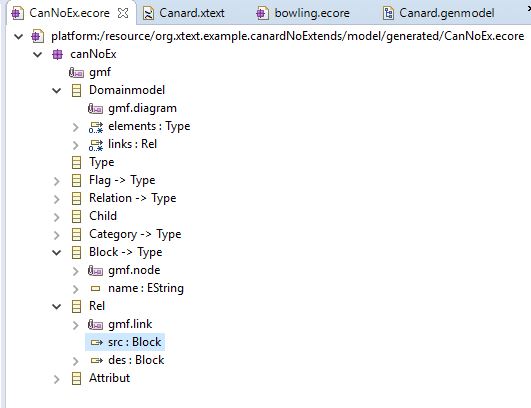

A picture of my ecore

I know that the problem is in the xtext definition of domainmodel, as I've done a test where 'Rel' was a subtype of 'Type' and this problem didn't pop.
I can't use the version mentioned just above because the 'Rel' isn't, in that case, doing a verification check to make sure the 'Block' linked do exist.
Thus, I would like to find a way to make the initial definition work.
