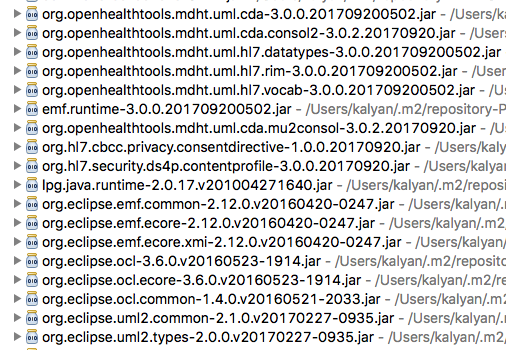

I'm getting similar errors on other types of CDA document using the online validator. Inline validation works fine. My version of mdht libraries 3.0.0.201709200502
