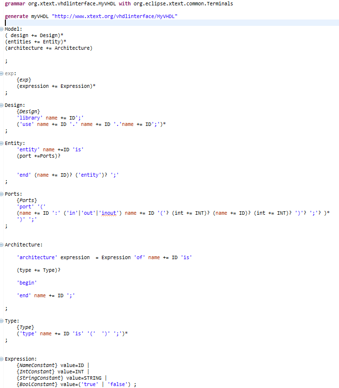

Home » Modeling » TMF (Xtext) » How to generate .vhdl code/template from my grammar(I have a written a short grammar in Xtext and I will like to write the Codegenerator to produce .vhdl code. I will paste the image of my grammar and my eclipse Application. Thanks for your help)

My question is how to write a Codegenerator for my above grammar so as to generate a .vhdl template.

Hi Dietrich, this is what I have tried so far.
* generated by Xtext 2.13.0
package org.xtext.vhdlinterface.generator
import org.eclipse.emf.ecore.resource.Resource
import org.eclipse.xtext.generator.AbstractGenerator
import org.eclipse.xtext.generator.IFileSystemAccess2
import org.eclipse.xtext.generator.IGeneratorContext
import org.xtext.vhdlinterface.myVHDL.Model
* Generates code from your model files on save.
* See https://www.eclipse.org/Xtext/documentation/303_runtime_concepts.html#code-generation
class MyVHDLGenerator extends AbstractGenerator {
override void doGenerate(Resource resource, IFileSystemAccess2 fsa, IGeneratorContext context) {
fsa.generateFile('code.vhdl', '' +
resource.allContents
.filter(Model)
.join(''))
Please throw a look and I will be very greatful for your feedback. Thanks
NB: I am completely new to this field.
Re: How to generate .vhdl code/template from my grammar [message #1793098 is a reply to message #1793095] Tue, 31 July 2018 03:39 Go to previous messageGo to next message
What do you mean by generate VHDL? It seems that you have (re)developed a VHDL grammar enabling you to edit VHDL files with Xtext. As such your input file is VHDL so there is nothing more to generate.

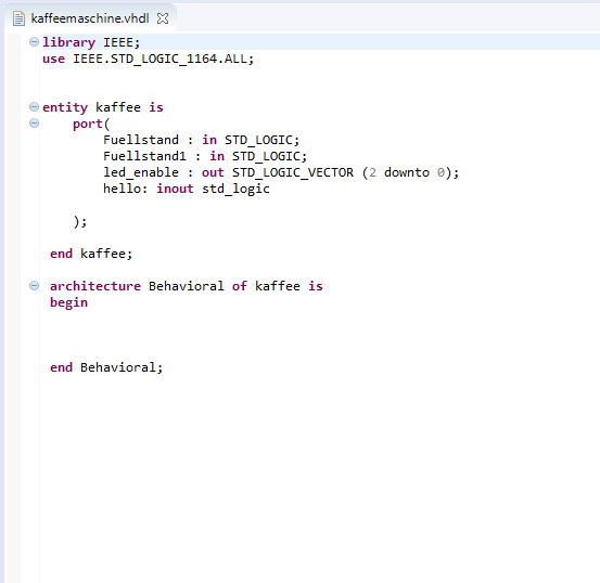

Exactly you got me right. I already have a .vhdl file and my aim was to write the grammar of that .vhdl file in xtext. So these were my ideas:
-> Develop the grammar
-> Run the developed grammar as an Eclipse Application
-> Write some common validators
-> Generate some codes with the code generator
Attached is the original .vhdl file which I wish to regenerate using XTEXT. I hope you will understand me now. Thanks alot

Yes my question is how to generate some codes with the code generator. From the grammar I posted right up. Please could you write a code generator for my grammar and show me? I think that will be the solution to my problem.

What code do you expect to generate?
If you want to convert the VHDL to masks for a silicon then you should look to the various silicon synthesis tools.
If you want to simulate the VHDL look at VHDL simulation tools.
