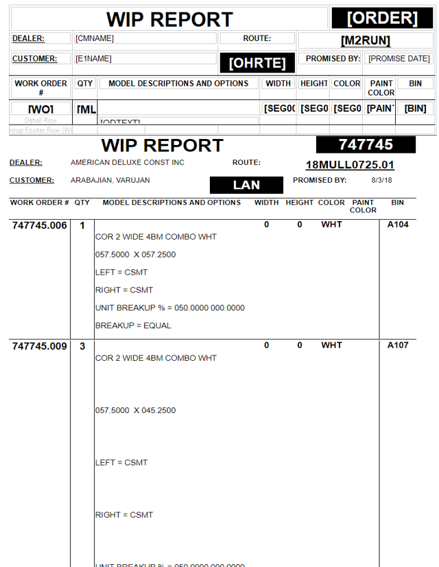

Good Afternoon all,
I am pretty new to BIRT and would definitely appreciate the help. Thank you in advance!
I am working with a report that is using two grouping sections.
-OrderNum (contains the Order Number only)
-WorkOrderNum (contains the Order Number and attached line item)
I am trying to suppress the duplicates however I am ending up with a lot of blank spaces inside the report detail area.
How do I suppress the duplicates as well as eliminate the space the duplicates they leave behind?
I am attaching an image of the results I am receiving.
Re: Eliminating blank spaces when suppressing duplicates [message #1793014 is a reply to message #1792981] Fri, 27 July 2018 09:58 Go to previous messageGo to next message
Can you do it in the query rather than the report? It would be helpful to know how you are attempting to do it now.
Re: Eliminating blank spaces when suppressing duplicates [message #1793027 is a reply to message #1793014] Fri, 27 July 2018 18:59 Go to previous message
I have attempted to eliminate the duplicates in the query. However I also need to pull in the BIN # on the right hand side of my images.
The BIN# for the children units are nested inside the Parent. So I cannot eliminate them from the query.
I do not know if it is possible to eliminate the blank spaces after suppressing the duplicates. This is providing a report that is from 15 pages to 120 pages. I need them to be as compressed as possible for production.
