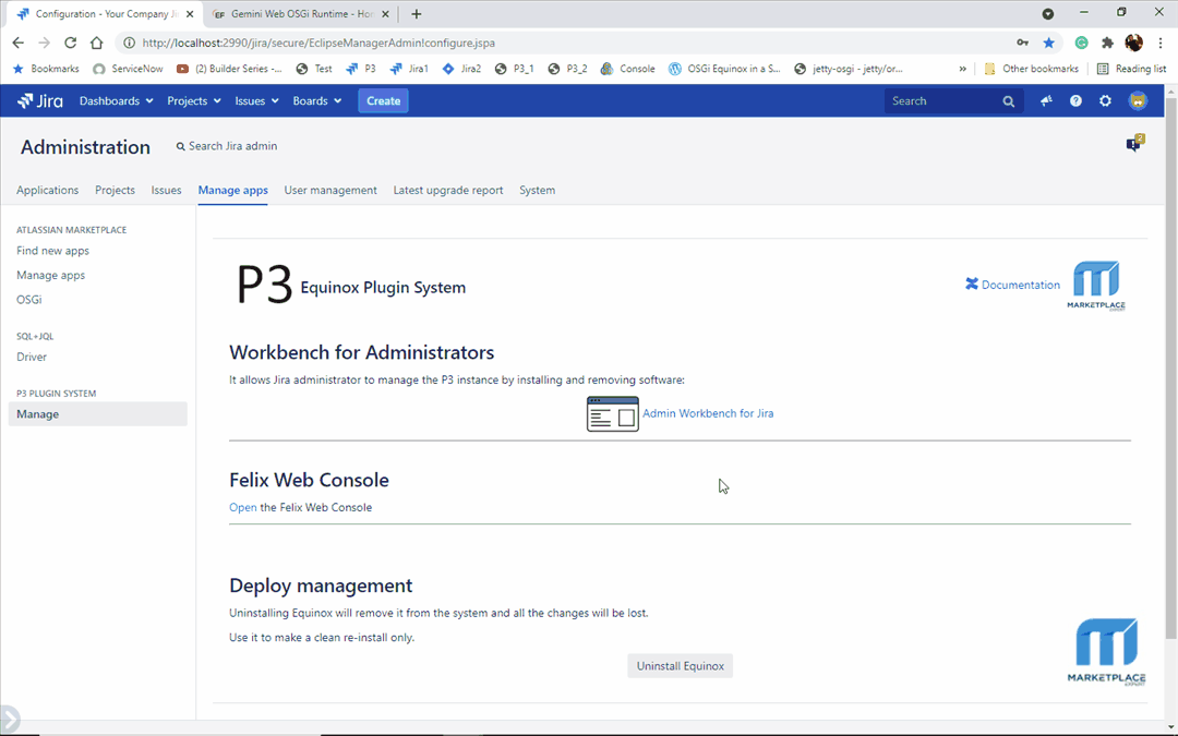

In the initial part of this recorded session (animated gif)...
index.php/fa/40505/0/
...Gemini Web is installed under the Servlet Bridge that is reachable at:
http://localhost:2990/jira/plugins/servlet/p3
The Web-ContextPath of the WAB is /test so it would be expected that the /hello servlet would be accessible at:
http://localhost:2990/jira/plugins/servlet/p3/test/hello
which returns a 404 Not found Error. Instead Gemini Web starts its own Tomcat instance as mentioned above and the WAB is reachable at:
http://localhost:8080/test/hello
As you see, this is useless because the user logged in against application deployed in the host Tomcat (http://localhost:2990/jira), so the user session is missing when you access via Gemini Web (http://localhost:8080)
If you are interested, the second part of the "video", it shows the same WAB example running on PAX-WEB under the same servlet bridge, that almost works: the WAB is detected and the servlet registered (like it happens with Gemini Web) but the Web-ContextPath ignored because a bug.
It would be nice if Gemini Web supports the Servlet Bridge.
This might seem a bit strange architecture but it would be really useful for the real World where reality overcomes software architects' imagination.
Pablo
