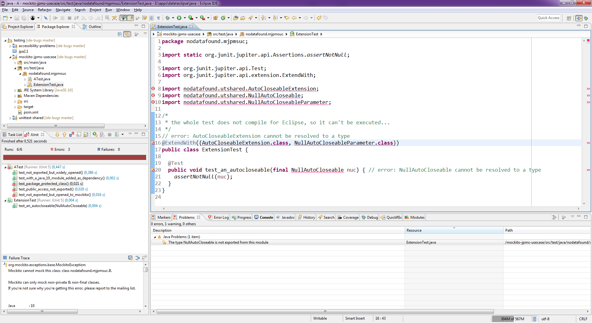

As promised, here is a sample : the ZIP file contains the following:
- a parent project
- first module unittest-shared containing classes that are shared across module
- second module mockito-jpms-usecase which provide an example of the errors I encounters;
This needs to be compiled with Maven 3.5.4 + a toolchains containing Java 10 (see https://maven.apache.org/ref/3.5.4/maven-core/toolchains.html ).
The project needs to be imported as "Maven project" in Eclipse. It should resolve itself.
For reference, it also present a problem with Mockito : https://stackoverflow.com/questions/50634322/java-modules-accessibility-problems-for-mockito-2-19-0 for which I fail to see what I can really do beside opening my module (which I don't want).
The ATest contains 5 tests, the ExtensionTest contains one test.
- In Maven, all tests are found: 3 are failing because Mockito can't access the class it tries to mock. It is dues to missing opens to package which mockito access, but I don't want to open more than needed (eg: the opens needs to be a "wide opens" and it needs to go in the module-info which is ugly).
- In Eclipse, all tests are found from src/test/java, but no test are found in ExtensionTest.java (eg: there is no Run As > JUnit Test), because it fails to compile as seen in https://www.eclipse.org/forums/index.php/fa/33489/0/
The console display this warning:
WARNING: Unknown module: nodatafound.unittest_shared specified to --add-reads
Mock for E, hashCode: 1966355106
nodatafound.mjpmsuc.B@616fe72b
As a user, I expect to be able to run test from the class because I'm writing the test or fixing a test. There should be no error (and the error is only displayed in the editor).
