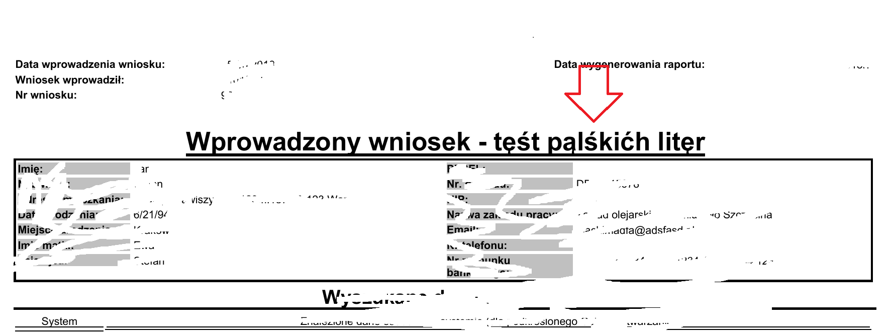

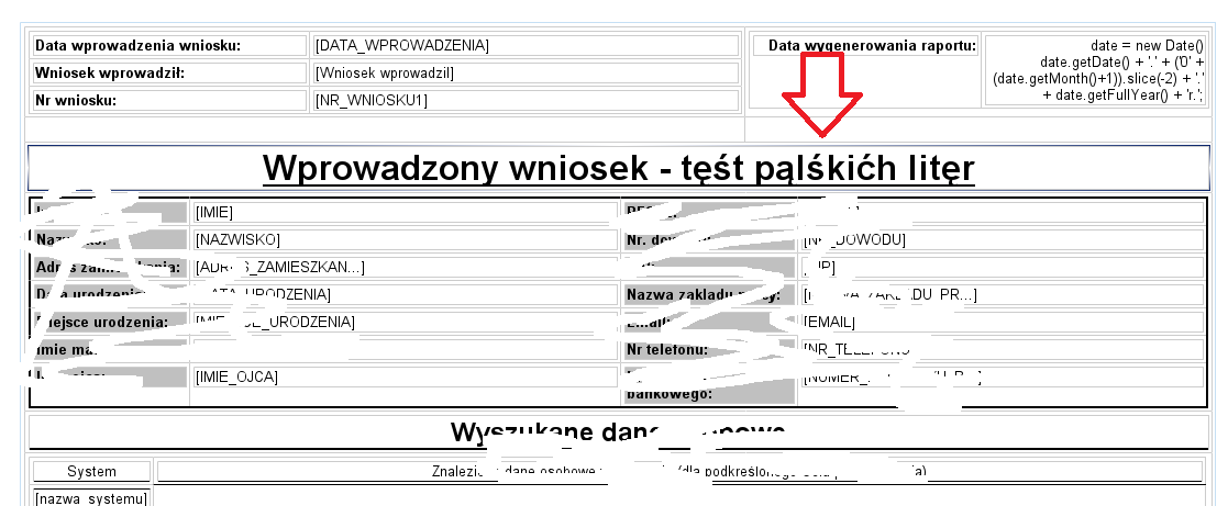

- birt-designer.png - this is screenshot form designer

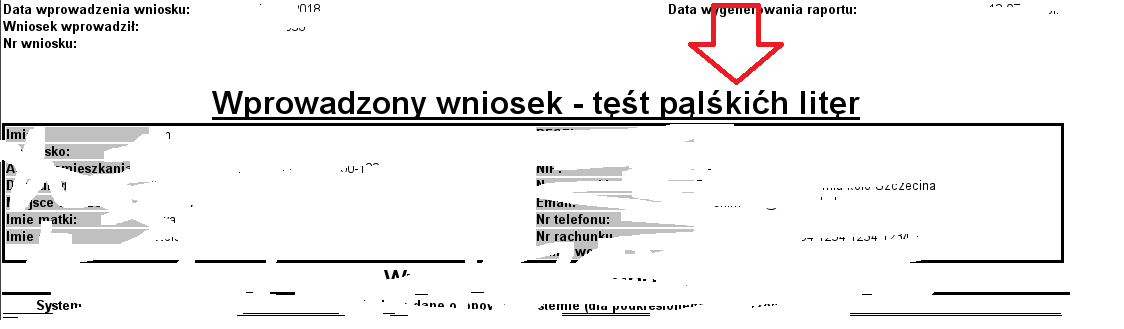

- birt-viewer.png - this is screenshot form webviewer, contains our national letters
- birt-viewer-pdf.png - this is screenshot from webviewer but report has been exported to pdf

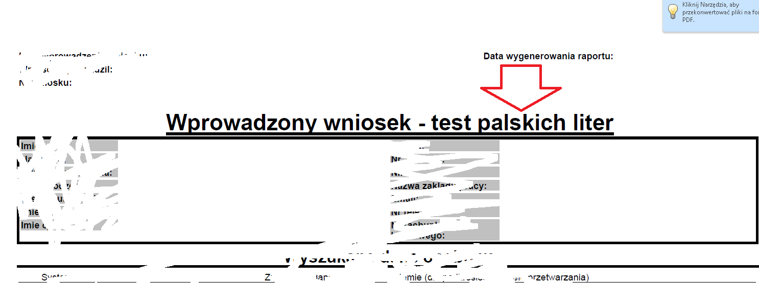

- birt-from-app.png - athis is screenshot from our custom app, look where arrow points -> no national letters :)

I found fix :). BIRT is working as expected but ... i'm using Sql server as DB which doesn't support UTF-8 in columns with text/varchar type. So change to ntext solved issue.
