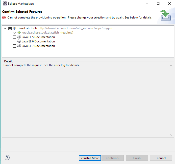

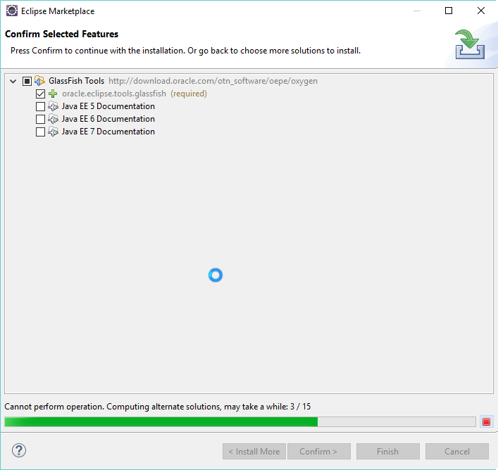

index.php/fa/33365/0/I'm trying to set up the Glassfish server on Eclipse but have had no luck. I'm on Java version 10.0.1
Steps:
1. Open Eclipse
2. Go to Help > Eclipse Marketplace
3. Search for GlassFish
4. Click on Install
5. Glassfish Tools and oracle.eclipse.tools.glassfish is selected. Click Confirm.
Result:
Installation progress bar says "Cannot perform operation. Computing alternate solutions, may take awhile." It eventually finishes and says "Cannot complete the request. See error logs for details."
Not sure where to find the error logs. I get this same error on both Eclipse Photon & Oxygen.

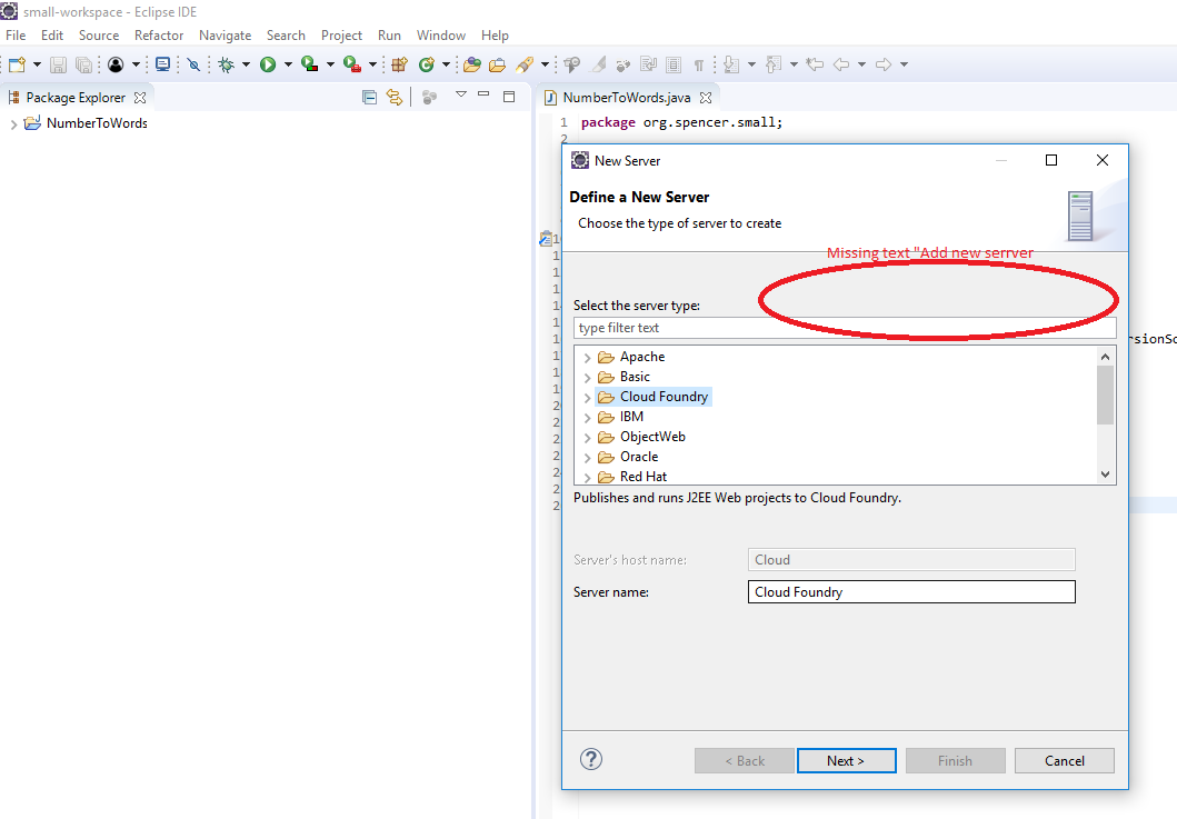

Having the same problem with Eclipse Luna. Running on Windows10.
In addition to this, there is no link on the Server view, where you can add additional servers.
index.php/fa/34548/0/
