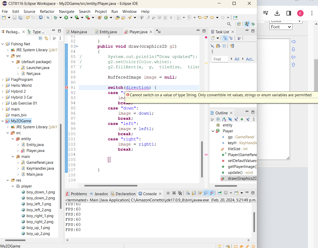

I'm using Version: 2023-12 (4.30.0)
Build id: 20231201-2043
and I'm getting this problem.
I'm using Amazon Corretto 17.0.9.8.1 btw.
I've included a screenshot showing the syntax error that appears unless I switch to "Use project specific settings."
Re: Project not using workspace Java compliance setting [message #1863784 is a reply to message #1863677] Mon, 26 February 2024 16:31 Go to previous message

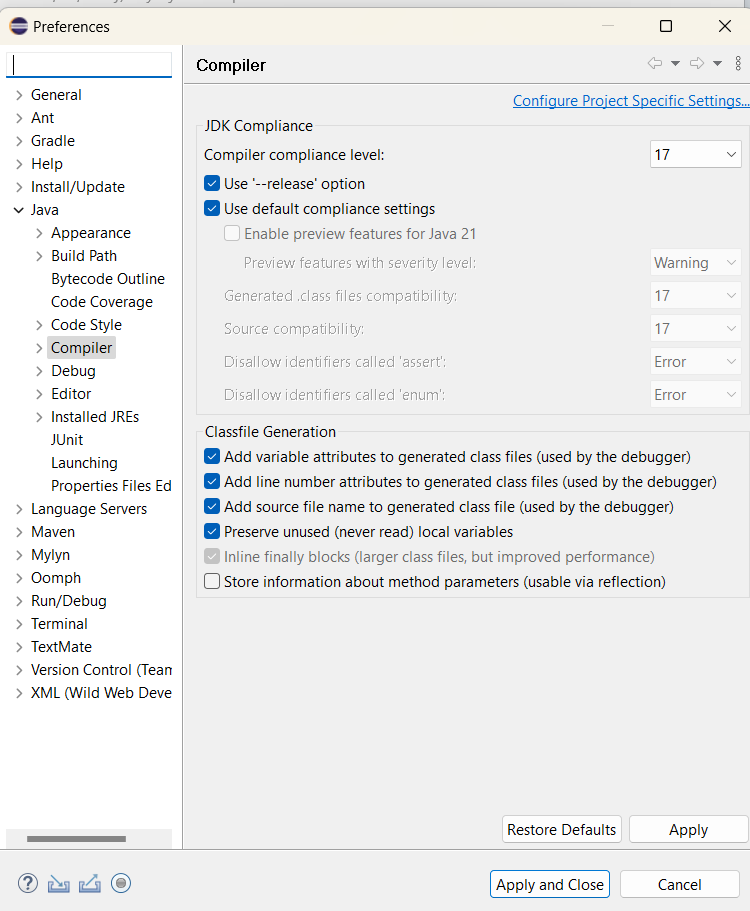

Never mind, I fixed it by changing the compiler compliance level to an earlier version, then changed it back to JDK 17, and it works now.
I don't need project specific settings.
