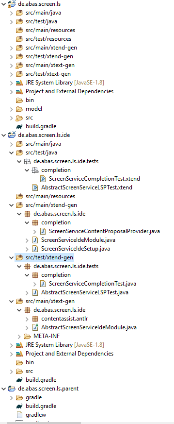

I added a screenshot of my project layout.

When I debug I can see that the field languageServer of the class AbstractLanguageServerTest is always null. What could be the problem?
