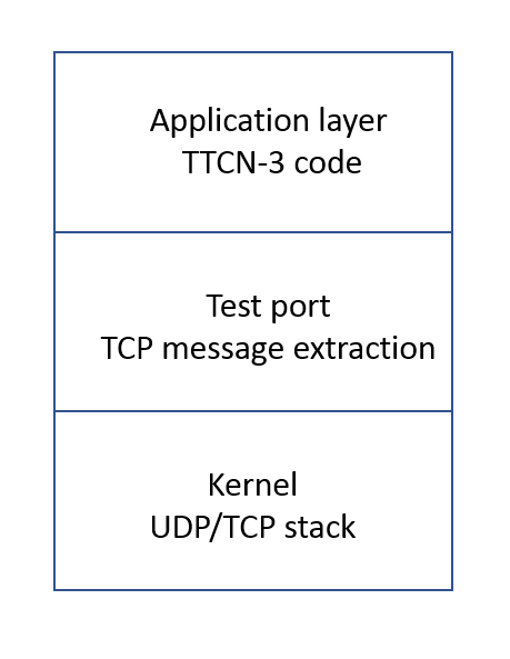

One more thing you should keep in mind: timestamping can be done in different protocol layers, see below:
index.php/fa/33465/0/
technically, for UDP timestamping can be done in the kernel , or the test port code , which connects the kernel stack to the abstract application layer written in TTCN-3 or in the application layer itself.
For TCP timestamping can only be done in the test port code (after message extraction), as the kernel is agnostic to the concept of TCP message , or the application layer.
Timestamping in the kernel might improve accuracy, but it's available for UDP only and it assumes the TTCN-3 real time extension, which is not yet supported by Titan.
However for TCP timestamping in the kernel is not an option. (this is the reason we did not add the real-time extension as it would not significantly improve the accuracy of timing in Titan)
