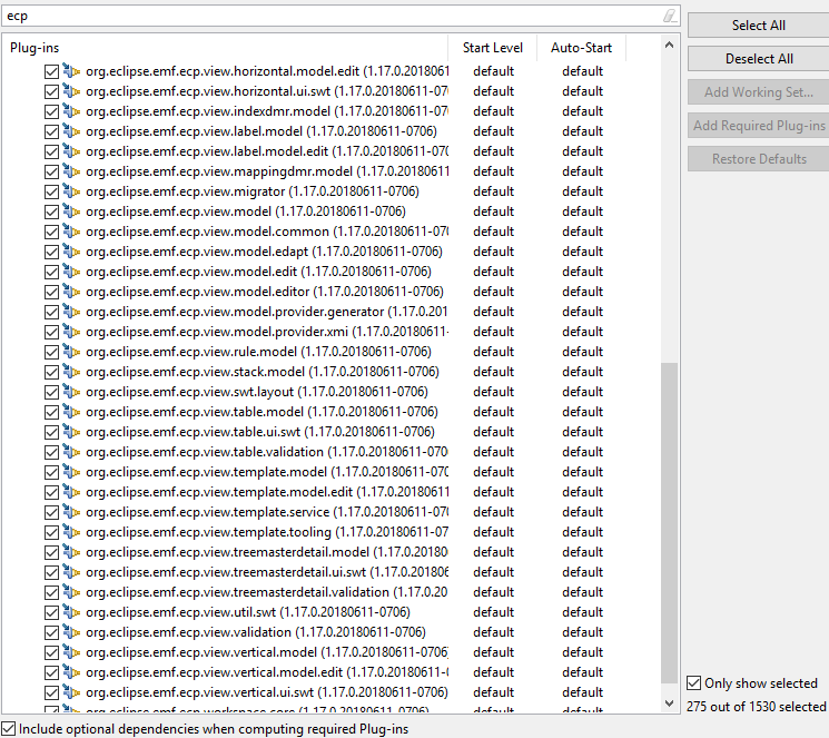

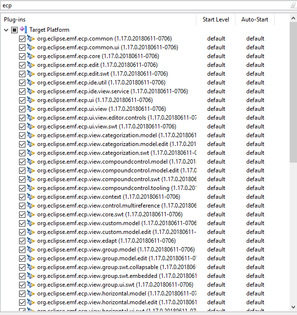

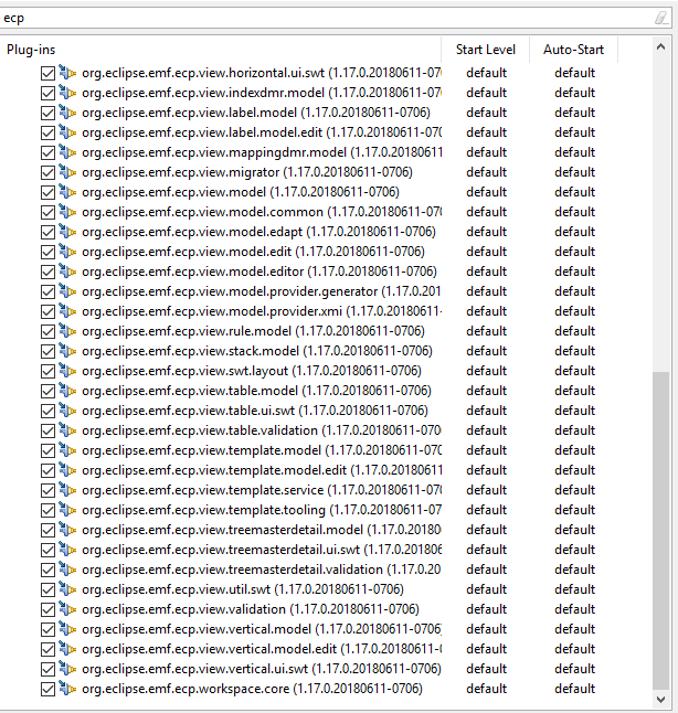

Hi was before on version 1.16 and in the run configuration I validate the plugins and all is OK
Here you will found all the pugins I use

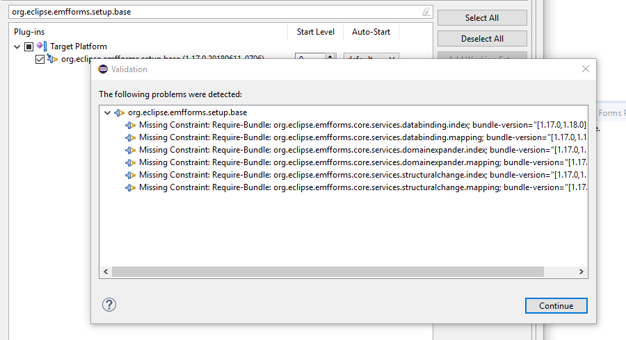

Re: Pb change version ECP [message #1791705 is a reply to message #1791700] Wed, 04 July 2018 08:27 Go to previous messageGo to next message
If i add this plugin ("org.eclipse.emfforms.setup.base") I am oblige to add (see attachement) but also I cannot anymore ignore *.indexdmr and *.mappingdmr bundles.
This doesn't solve the problem still the same error!!!
