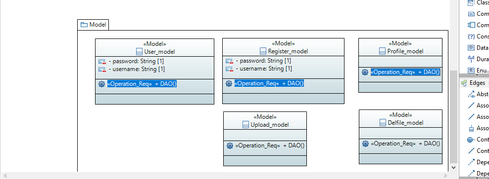

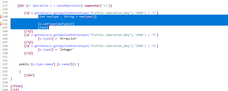

Re: Self(Operation).setType(newType: Type) [message #1791625 is a reply to message #1791606] Tue, 03 July 2018 07:16 Go to previous messageGo to next message
Israr Ahmad is currently offline Israr AhmadFriend
Messages: 4
Registered: July 2018
Junior Member
Hey:
Ok, I have attached two .PNG file where you can see in "UML class diagram" file, operations "DAO" without return type and a applied stereotype "Operation_Req" which will be decide its return type in M2T transformation code.
In Second file "M2T-Code", where I want to generate code of return type of DAO operation with the help of applied stereotype.
Kindly help me how can do it?
Regards:
Re: Self(Operation).setType(newType: Type) [message #1791640 is a reply to message #1791625] Tue, 03 July 2018 09:02 Go to previous message
Ed Willink is currently offline Ed WillinkFriend
Messages: 7627
Registered: July 2009
Senior Member
Screen shots do not provide a repro, but in this case I can perhaps guess at what you are trying to do; you might find https://wiki.eclipse.org/OCL/ForumNetiquette helpful.
Acceleo is a Model to Text language so most expressions contrbute output text. [o.setType(newType)/] does not obviously have an text value and appears to attempt to modify the input model which is illegal in a declarative language. If the value in o.type does not suit your [urposes you propbabkly want to write a getType() helper that returns the corrected working value rather than trying to correct the input.
