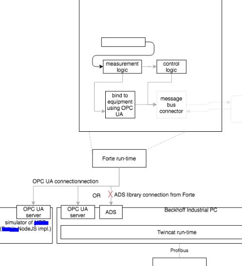

Dear 4Diac-cers,
I am new to IEC 61499 environment, I have implemented a few academic projects in FBDK IDE.
I have a Beckhoff PLC and a mini paper pulp processing plant, for which I am planning to create a forte RTE, on which my designated Control App which (will be) made in Eclipse 4Diac IDE run. I will be using OPC-UA as a communication protocol between them.
The first Stage of the project will be to implement, the Process simulation using 4DIAC RTE on OPC-UA and than, the PLC for Pulp paper process plant. The simulator has been already implemented in Node JS.
Just before getting started, I want to ask a few questions.
• Suggest me, how I can go about creating a forte Runtime Environment for a PLC, which has its own Function Blocks?
• Can the generic Function blocks provided by 4Diac be used to program a proprietary PLC, and can one setup a RTE for the same or I can download a certain library for my task?

Re: Control System app for Beckhoff Using OPC-UA [message #1791559 is a reply to message #1791557] Mon, 02 July 2018 09:29 Go to previous messageGo to next message
although I am not 100% sure if I understood correct, what you want to do, I throw in my 2 cents.
For your first question, regarding how to create a FORTE with custom function blocks, please refer to the the online help of 4diac (https://www.eclipse.org/4diac/en_help.php)
To your second questions: Quick answer: No
Longer answer, Beckhoff PLCs are based on the IEC 61131 standard, which, besides it is a cycle-based execution environment without event, does NOT define a standardized way, how a programming tool shall interact with the run-time environment. In fact, Beckhoff's TwinCAT utilized the Visual Studio compiler suite to compile a specific executable, which implements the program designed in TwinCAT.
So there are three ways to proceed from here:
1. Use OPC UA to also communicate with TwinCAT - should work as OPC UA is a standard. I have never done this, so I cannot provide any hints here.
2. Use Beckhoff's ADS interface to communicate with TwinCAT - I have already done this, works ok, but you cannot do real-time control over ADS (same as OPC UA), but you can set reference values easily via ADS and have the control algorithm programmed in TwinCAT.
3. Implement/find a working EtherCAT master stack - Depending on your requirements the Simple Open EtherCAT Master could be sufficient for your task. With that, you can completely replace TwinCAT and communicate directly with the Beckhoff components controlling your plant.

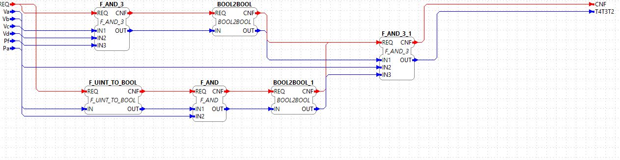

Re: Control System app for Beckhoff Using OPC-UA [message #1792890 is a reply to message #1792888] Wed, 25 July 2018 08:11 Go to previous messageGo to next message
Ok, I think I get it now, but I still don't know where exactly you need help now. Do you wan to offer the inputs as OPCUA vairables that the PLC can trigger and then offer the outputs also sa OPCUA variables?
Re: Control System app for Beckhoff Using OPC-UA [message #1792897 is a reply to message #1792890] Wed, 25 July 2018 08:57 Go to previous messageGo to next message
Please look at the logic diagram below.
I hope you get a better idea from that.
  • Attachment: Logic.JPG
    (Size: 33.31KB, Downloaded 197 times)

Furthermore I noticed that in your CFB you are duplicating events. That means for one input event you are sending two output events. Maybe that it is not what you want. also I would expect that a basic FB would be more efficient for the tasks you need.
Re: Control System app for Beckhoff Using OPC-UA [message #1792939 is a reply to message #1792899] Thu, 26 July 2018 04:12 Go to previous messageGo to next message
Dear Alois,
The snapshot I pasted in the above thread is, what we want my FB to work like. 5 different function blocks (almost) on the same concept are created.
Which (Should) perform operation and give the desired outputs.
We are planning that each of the CFB should perform individual for each individual process in the simulator. It might not be logically correct but its what we are intending to do.

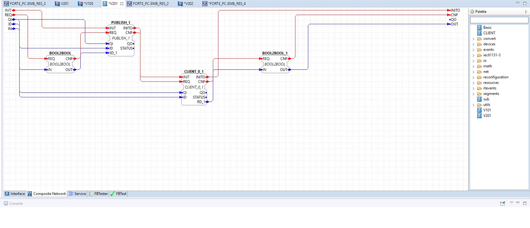

Dear All,
I have tested all the values coming from different nodes by the method you helped me do last Thursday.
My application takes 31 values in total, out of which, 27 BOOL values, 4 UNIT values.
Initially, I was thinking to make composite blocks for each of the nodes, to read and write the values, but I guess that is not possible.
index.php/fa/33848/0/
If I go by the procedure by implementing the same logic for each nodes, it will be quite messy, there will be dozens of tabs at the same time to operate the application.
I have a few question regarding the application.
*What procedure of implementation should I follow to keep the application as simple as possible? What are your recommendations?
*There should be one Client/Publish (node) per EMB-RES?
Best
Ahsan
  • Attachment: NwBlck.JPG
    (Size: 208.80KB, Downloaded 1221 times)
[Updated on: Mon, 10 September 2018 05:10] by Moderator

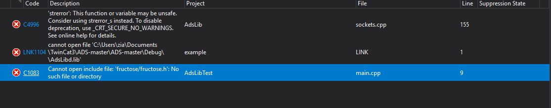

Re: Control System app for Beckhoff Using OPC-UA [message #1796668 is a reply to message #1796580] Wed, 17 October 2018 05:36 Go to previous messageGo to next message
Dear Martin,
Is there any documentation or tutorial for the compiling or usage of the ADS library?
I am having trouble, not getting any detailed documentation for the method to follow.
P.S: I get the following error when compiling the library using VS17.
Thank you.
Best Regards,
Ahsan Zia
  • Attachment: ADS.JPG
    (Size: 37.87KB, Downloaded 150 times)
Re: Control System app for Beckhoff Using OPC-UA [message #1796675 is a reply to message #1796668] Wed, 17 October 2018 07:34 Go to previous messageGo to next message
Dear Ahsan,
as I am not involved with the ADS library project, my knowledge is limited. You can ignore the error regarding fructose, as this is only needed for the tests for the library.
The solution for the first error is given in the error message itself, so just add the stated define to your project.
The middle error will disappear as soon as the first error is resolved.
Martin
