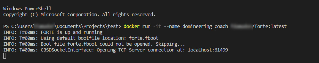

Ok, So I finally was able to compile forte on Alipine Linux @ 35MB! with the standard libraries (musl-dev).
In my investigation, I created an ubuntu and debian image and they installed just fine. After dealing with the libraries, I finally edited the following command line in your ConditionSynch.cpp line 30 code:
from:pthread_mutexattr_settype(&mutexAttr, PTHREAD_MUTEX_RECURSIVE_NP);
to: pthread_mutexattr_settype(&mutexAttr, PTHREAD_MUTEX_RECURSIVE);
Not sure why _Cygwin_ would only need the correct datatype as oppose to the rest of the system. Please advise if this is safe to do!!!
My final output for running my new container from the created image is as follows: See Attached Image
Here is my new Dockefile: See attached File.
NOTE: The copied forte directory has the /src/posix/arch/conditionSynch.cpp file modified as above.
Franklin
