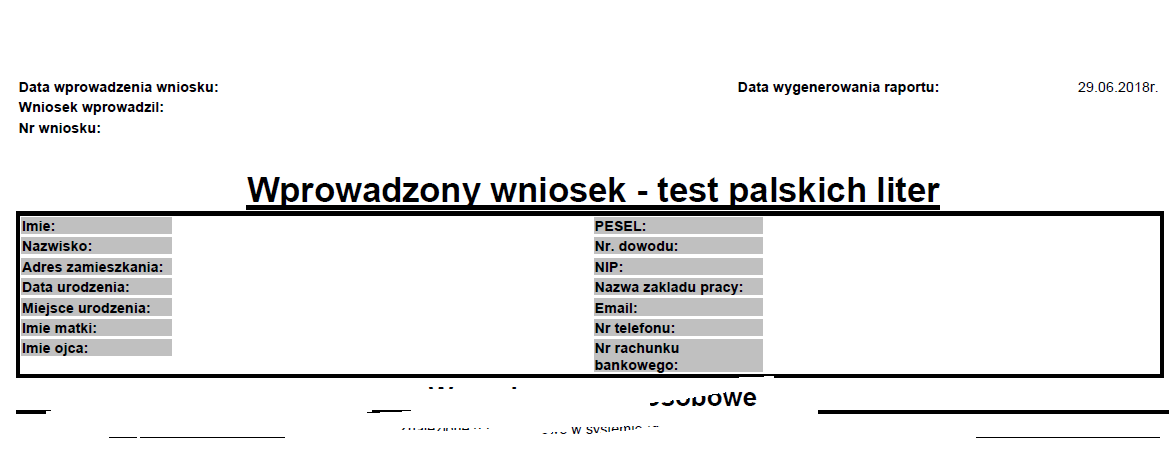

at first i need to say that BIRT is awesome project :)
but
I have problem with - i guess - character encoding(to be exact with Polish characters) in designer and in our application which is using birt as PDF rendering engine. In our application it reveals by switching our national signs like ę,ś,ć with ASCII(?) ones like e,s,c and so on. In BIRT designer after rendering to PDF our national characters are correct but ... they looks wired :) - like from different font.
You can see what i mean on examples that i had rendered from designer and from our app
1'st one app-pdf.png is from app :)
2'nd one designer-pdf.png is from BIRT designer
