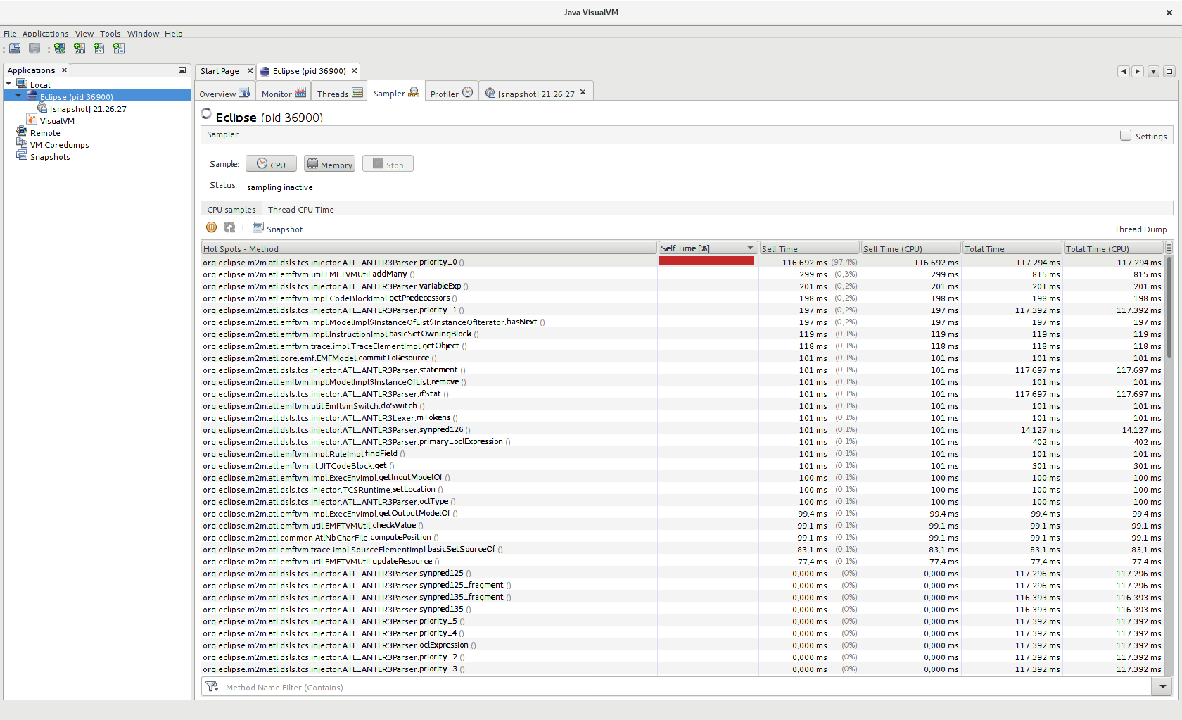

Re: Long ATL file taking much time to save in Eclipse [message #1791453 is a reply to message #1791352] Fri, 29 June 2018 13:20 Go to previous messageGo to next message
I've reproduced your problem: this is indeed not workable. The problem is the ATL parser, which is not efficient in parsing imperative "do" block code, i.e. the large pieces of code in your called rules. I've attached my measurements (you can load the .nps file in jvisualvm for a detailed analysis).
You may log a bug for this in the Eclipse Bugzilla.

There is indeed a performance issue with parsing large action blocks (aka. 'do' blocks) containing many nested if statements.
Most of the time parsing your ATL file is spent parsing rule connectNodes, which contains such an action block.
Here is a first workaround to try:
- put rule connectNodes in a separate ATL file (e.g., connectNodes.atl)
- keep all other rules in the first ATL file,
- superimpose both files for execution.
connectNodes.atl will still require a long parsing time, but you should be able to work on your other rules normally.
A second workaround (that may be combined with the first one) is to divide rule connectNodes into several subrules, avoiding having a single rule with too many nested if statements.
