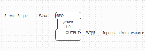

Re: Creating an array and giving it as FB output [message #1791280 is a reply to message #1791279] Wed, 27 June 2018 10:03 Go to previous messageGo to next message
We have a test for that as well. Just to be clear how did you define your output data type. did you use ARRAY or did you use INT and specifiy the array size of 3 in the interface editor. You have to do the latter.
Re: Creating an array and giving it as FB output [message #1791282 is a reply to message #1791280] Wed, 27 June 2018 10:41 Go to previous messageGo to next message
It seems that this way it works. Thank you!
index.php/fa/33241/0/

      CIEC_ARRAY nTest(3, g_nStringIdINT);
      nTest.fromString("[1,2,3]");
      OUTPUT_Array().setValue(nTest);
      char val[10] = "";
      OUTPUT()->toString(val, sizeof(val));
      DEVLOG_DEBUG("OUTPUT is %s\n", val);
      break;
