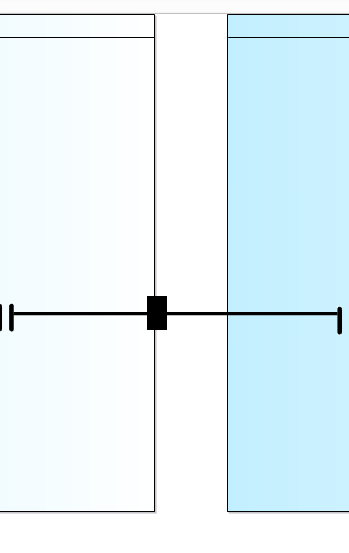

I have an edge which connects elements A and B on the diagram. Element A is in container1 and Element B is in container2. I have created a BorderedNode on the container1 and forced the edge to go through the bordered node in between. Thus the edge will be like: ElementA -------BorderedNode------ElementB.

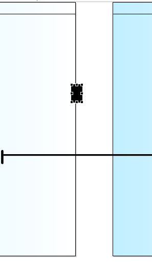

The issue is that when I move the bordered node the edge does not ALWAYS move with it. However, if I drag the edge again, it finds the path and fixes the issue. Basically it happens when: I select the edge, then I select the BorderedNode and move it. In this case the edge looks like ElementA ----- Element B and ignores the BorderedNode which is defined in the Path Expression.
I guess it is a bug, but do you suggest any ways to fix it ? I was thinking of rearranging the edge in the RefreshVisual() method of the BorderedNode edit part, so when the borderednode gets refreshed (or moved), it rearranges the edge and it fixes it self.
Can you help me on how to run arrange command (or sth similar) on an edge edit part?
index.php/fa/33199/0/
When I move the bordered node:
index.php/fa/33200/0/

Can anyone please say if there is a fix for it ?
