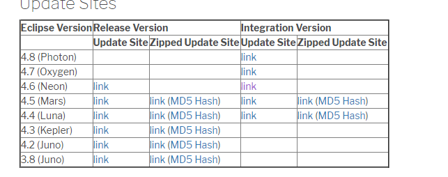

Hello
im using Eclipse 4.8 on my local pc
this pc is not connect to the internet in any way, and it cannot be connected. i just cant connect it to the internet !
i can only download from another pc and copy it by USB DISK ON KEY.
so i need windowbuilder for Ecplipse 4.8(photon) and i can see that there is no manual download link for that version (image attached)
can you please tell me what to do ? or what can i do ?
does the download link should be available soon ?
:) thanks

Hi Tsahi,
here it is: go to page
http://download.eclipse.org/windowbuilder/WB/integration/4.8/
click on "Show directory contents"
and download repository.zip.
Then from Photon, Install New Software, Add, Archive, select the zip file, give a name for this update site and proceed.
HTH
Vincenzo
