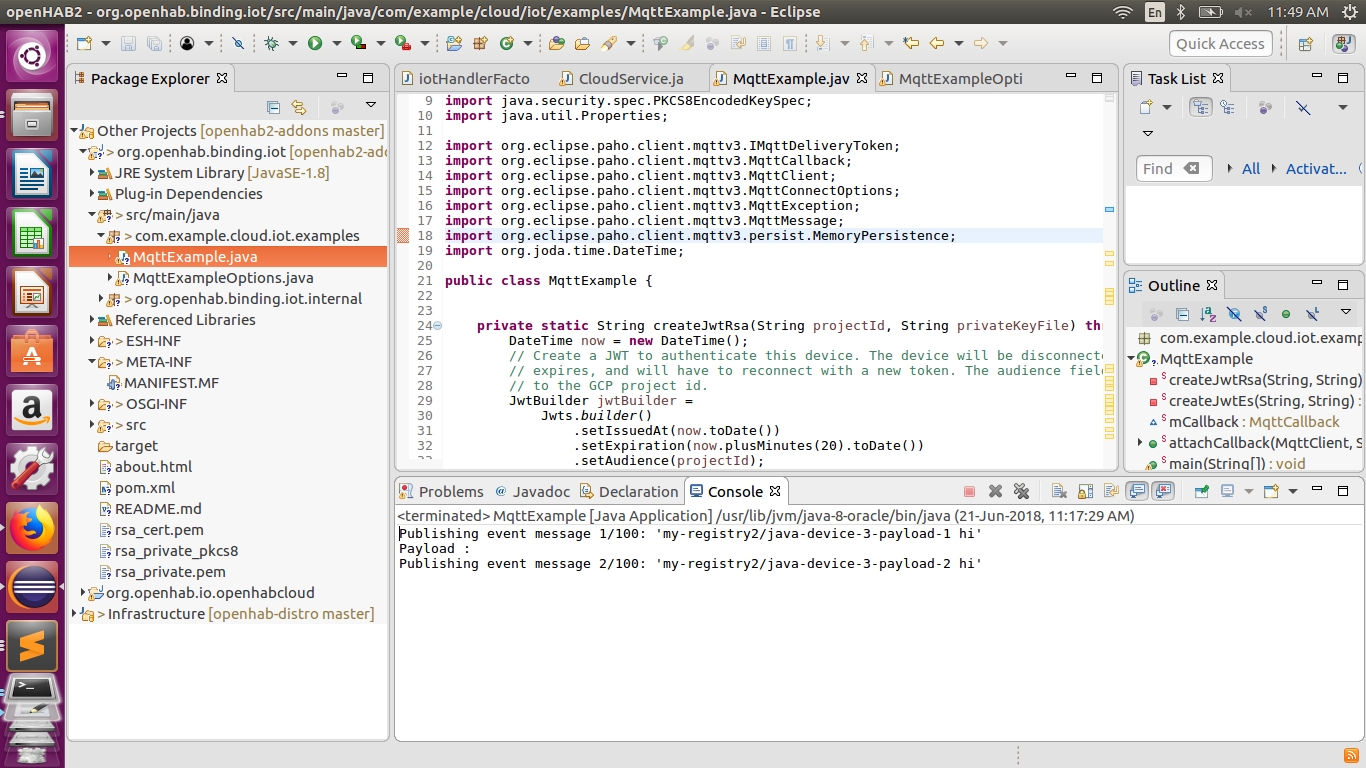

following attachment consists of binding structure.
Note:If I run MqttExample.java alone in java application I am able publish the event message.
This java class embedded in a binding to the ESH framework is successfully run by "standalone" but I am not able to run this java class through binding.
please help me to resolve this issue.

Reading from your screenshot your example contains a "main" method and thus you are able to "run it standalone" as a java program. Just copying over this class into a binding does not make it run as Henning said.
Are you familiar with (Java) programming? Please have a look at the documentation https://www.eclipse.org/smarthome/documentation/development/bindings/how-to.html
Basically you have to create a ThingHandler plus a xml description file, which has to embed parts of the code that your example contains.
Stefan
Re: ESH Google IoT core binding [message #1791163 is a reply to message #1791049] Mon, 25 June 2018 07:31 Go to previous messageGo to next message
Hi Stefan thanks for the reply,
As you said my example contains a "main" method and thus I am able to "run it standalone" as a java program.
I just want to compile and get the output (Eg:print "hellowrold" in the console) from that newly created java class when the "binding is running".
I would like to know how the controlflow works in ESH binding to execute that newly created java class(through Eclipse IDE).
please help me out to resolve this issue
Re: ESH Google IoT core binding [message #1791635 is a reply to message #1791163] Tue, 03 July 2018 04:32 Go to previous message
Hello Paramesh,
you can have a look at the ThingHandler documentation: https://www.eclipse.org/smarthome/documentation/development/bindings/thing-handler.html where you can see what is executed when.
To have a simple "hello world" printed to the console just put it into the "handleCommand" method, bind an item to a channel of your thing and change the status of the item (i.e. via entering smarthome update MyItem "newState" into the console of your IDE).
Stefan
