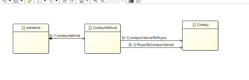

1)Im new to sirius I went through the concepts of sirius I was not able to understand about Container drop. Can someone Please explain me about container drop using some example
2)I have to create the following
Elemets->computationMethod->feature(compuInternalToPhys)->compu
Elemets->computationMethod->feature(PhyscompuInternalTo)->compu
I need to create the container compu with different features.How to create compu in sirius.
Please help me in this
Attaching
  • Attachment: Capture.PNG
    (Size: 16.45KB, Downloaded 276 times)

Hello
Your purpose is to create instance of class so I make the supposition that you 've already defined the mapping and all what is needed to display your entities in a diagram.
Then you may use either ContainerCreation Tool to crate a new instance or Container Drop tool to display in your diagram an existing instance
You can read the documentation about container drop : https://www.eclipse.org/sirius/doc/specifier/diagrams/Diagrams.html#containers
Do not forget to add some model operations
For example, if your source selection is from the model explorer, just add a ChangeContext operation that do nothing (var:element)
You have some example of Container Drop tool here: https://github.com/eclipse/ecoretools/blob/master/org.eclipse.emf.ecoretools.design/description/ecore.odesign
