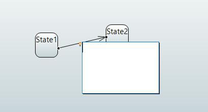

Hello.
I need to disable popup textedit after connecting transition from one state to another. Popyrus version is 2.0.2.
Thanks for your help.
  • Attachment: textedit.jpg
    (Size: 6.00KB, Downloaded 112 times)
Re: disable textedit after connecting transition [message #1791987 is a reply to message #1790740] Mon, 09 July 2018 07:15 Go to previous message
as far as I know, it is not possible to do that directly, as the "performEdit" request gets triggered after creation. However, you could register a text editor for transitions that does nothing and assure that it has the highest priority (See preferences->Papyrus->Embedded Editors). For the moment, we do not have such an editor, but you could replace the xtext based editor for transitions with a simple name editor. Btw., for which use case do you want to disable editing?
