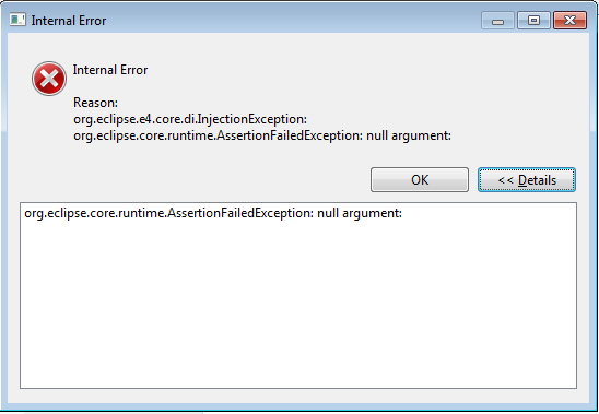

I added in my plugin.xml , dependece tab all
  • org.python.pyedev.*
  • org.eclipse.ui.*
I added too a button with the code that i mentioned after.
I have the following error, has you see in the image attached.
index.php/fa/33142/0/
I have installed the java version 1.8.0_161
Regards.
Re: how to add python perspective in rcp [message #1790818 is a reply to message #1790790] Mon, 18 June 2018 09:57 Go to previous messageGo to next message
You should specify features, not bundles. Only use bundles when you have intimate knowledge of why particular bundles should be excluded: although p2 will normally install most dependencies, p2 may not be able to find decoupled dependencies that are expressed via mechanisms like OSGi services and the Eclipse Plugin registry. You probably want to include the `org.eclipse.platform` feature, which is the base for most IDEs, and then include the PyDev features.
