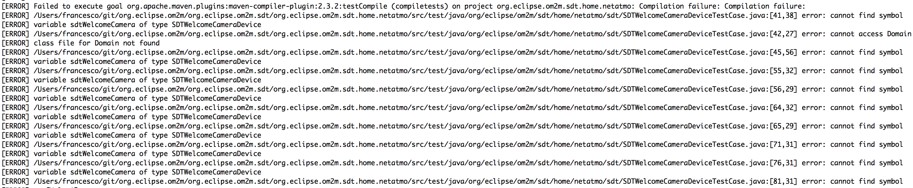

Hi, I'm trying to build om2m with eclipse oxygen.
When I follow the step "Select "org.eclipse.om2m" package and right click. Select "Run as -> maven install"" I have this error
Failed to execute goal org.apache.maven.plugins:maven-compiler-plugin:2.3.2:testCompile (compiletests) on project org.eclipse.om2m.sdt.home.netatmo: Compilation failure: Compilation failure:
[ERROR] /Users/francesco/git/org.eclipse.om2m/org.eclipse.om2m.sdt/org.eclipse.om2m.sdt.home.netatmo/src/test/java/org/eclipse/om2m/sdt/home/netatmo/sdt/SDTWelcomeCameraDeviceTestCase.java:[41,38] error: cannot find symbol
[ERROR] variable sdtWelcomeCamera of type SDTWelcomeCameraDevice
[ERROR] /Users/francesco/git/org.eclipse.om2m/org.eclipse.om2m.sdt/org.eclipse.om2m.sdt.home.netatmo/src/test/java/org/eclipse/om2m/sdt/home/netatmo/sdt/SDTWelcomeCameraDeviceTestCase.java:[42,27] error: cannot access Domain
[ERROR] class file for Domain not found
[ERROR] /Users/francesco/git/org.eclipse.om2m/org.eclipse.om2m.sdt/org.eclipse.om2m.sdt.home.netatmo/src/test/java/org/eclipse/om2m/sdt/home/netatmo/sdt/SDTWelcomeCameraDeviceTestCase.java:[45,56] error: cannot find symbol
[ERROR] /Users/francesco/git/org.eclipse.om2m/org.eclipse.om2m.sdt/org.eclipse.om2m.sdt.home.netatmo/src/test/java/org/eclipse/om2m/sdt/home/netatmo/sdt/SDTWelcomeCameraDeviceTestCase.java:[55,32] error: cannot find symbol
[ERROR] /Users/francesco/git/org.eclipse.om2m/org.eclipse.om2m.sdt/org.eclipse.om2m.sdt.home.netatmo/src/test/java/org/eclipse/om2m/sdt/home/netatmo/sdt/SDTWelcomeCameraDeviceTestCase.java:[56,29] error: cannot find symbol
[ERROR] /Users/francesco/git/org.eclipse.om2m/org.eclipse.om2m.sdt/org.eclipse.om2m.sdt.home.netatmo/src/test/java/org/eclipse/om2m/sdt/home/netatmo/sdt/SDTWelcomeCameraDeviceTestCase.java:[64,32] error: cannot find symbol
[ERROR] /Users/francesco/git/org.eclipse.om2m/org.eclipse.om2m.sdt/org.eclipse.om2m.sdt.home.netatmo/src/test/java/org/eclipse/om2m/sdt/home/netatmo/sdt/SDTWelcomeCameraDeviceTestCase.java:[65,29] error: cannot find symbol
[ERROR] /Users/francesco/git/org.eclipse.om2m/org.eclipse.om2m.sdt/org.eclipse.om2m.sdt.home.netatmo/src/test/java/org/eclipse/om2m/sdt/home/netatmo/sdt/SDTWelcomeCameraDeviceTestCase.java:[71,31] error: cannot find symbol
[ERROR] /Users/francesco/git/org.eclipse.om2m/org.eclipse.om2m.sdt/org.eclipse.om2m.sdt.home.netatmo/src/test/java/org/eclipse/om2m/sdt/home/netatmo/sdt/SDTWelcomeCameraDeviceTestCase.java:[76,31] error: cannot find symbol
[ERROR] /Users/francesco/git/org.eclipse.om2m/org.eclipse.om2m.sdt/org.eclipse.om2m.sdt.home.netatmo/src/test/java/org/eclipse/om2m/sdt/home/netatmo/sdt/SDTWelcomeCameraDeviceTestCase.java:[81,31] error: cannot find symbol
I'm working on Mac osx High Sierra v 10.13.5 and I'm using java 1.8.0_172-b11.
Thanks in advance for your help
