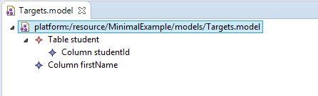

Re: Run Etl [message #1794885 is a reply to message #1794354] Mon, 10 September 2018 06:24 Go to previous messageGo to next message
Hello Dimitris Kolovos,
Thank you very much for your guide. The code worked, but The created "column" in target model doesn't have Value. I tried to fix it, but it didn't solved. Please guide me?
I prepared a minimal example and an image that show the target model. The minimal example contains EtlStandaloneExample.java file. Please run it.
Best Regards,
Marzieh
Re: Run Etl [message #1795139 is a reply to message #1794885] Sun, 16 September 2018 13:48 Go to previous messageGo to next message
Hi Marzieh,
The attached minimal example has a compilation error as EtlStandaloneExample is in the wrong package. When I fixed this, it threw a runtime exception as there's no models/Targets.model. Intuitively, I renamed Table-Targets.model to Targets.model and then it ran to completion printing "student" in the console. Looking at your code, I cannot find any comments that indicate where the problem is or what behaviour you would have expected. Could you please explain the problem you're encountering a bit more with references to specific lines of code?
Cheers,
Dimitris

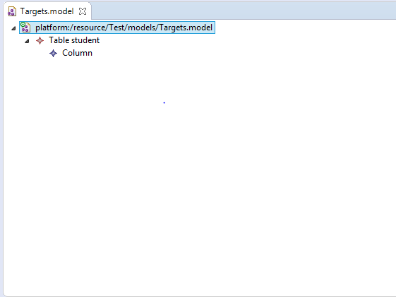

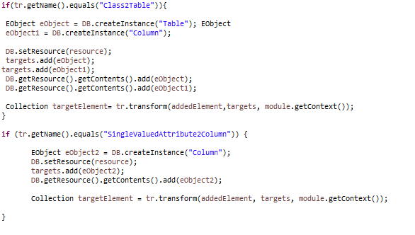

Re: Run Etl [message #1795175 is a reply to message #1795139] Mon, 17 September 2018 15:04 Go to previous messageGo to next message
Excuse me for mistake occurred in attaching the minimal Example.
I want to run the "Class2Table" directly with use the Transform(..) method. When I run the codes exists in minimalExample, no error message was seen in console. In other words the rule "Class2Table" has been executed and target model ("Targets") has been generated, but the generated target model has a problem. It has an element of kind of table with name "TableStudent" and an element of kind of Column without any name. (please See figure,( "Targets.PNG"))
Now, problem is that the column hasn't any name. How can I solved it?
Best Regards,
Marzieh
Re: Run Etl [message #1795263 is a reply to message #1795175] Wed, 19 September 2018 07:59 Go to previous messageGo to next message
Hi Marzieh,
Running EtlStandaloneExample.java produces the following exception in my setup:
Exception in thread "main" Property 'extends' not found in object org.eclipse.emf.ecore.impl.DynamicEObjectImpl@4d95d2a2 [eClass: org.eclipse.emf.ecore.impl.EClassImpl@53f65459 [name: Model] [instanceClassName: null] [abstract: false, interface: false]]
	at (unknown@0:0-0:0)
	at (/Users/dkolovos/Projects/Eclipse/eclipse-modeling-photon-r/runtime-New_configuration/MinimalExample/bin/etl/OO2DB.etl@49:1-67:2)
	at (/Users/dkolovos/Projects/Eclipse/eclipse-modeling-photon-r/runtime-New_configuration/MinimalExample/bin/etl/OO2DB.etl@49:5-49:28)
	at (/Users/dkolovos/Projects/Eclipse/eclipse-modeling-photon-r/runtime-New_configuration/MinimalExample/bin/etl/OO2DB.etl@49:5-49:16)
The reason is that in line 188, "Element" is an instance of Model as opposed to an instance of Class.
Cheers,
Dimitris

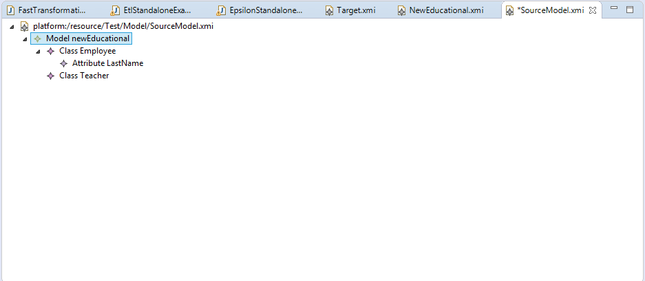

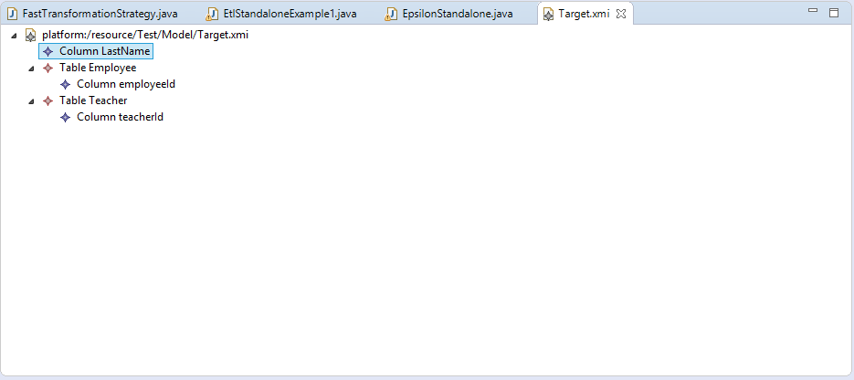

Re: Run Etl [message #1796151 is a reply to message #1795447] Sat, 06 October 2018 08:36 Go to previous messageGo to next message
Hello Dimitris,
Consider the "oo2db.etl" transformation. I run the "SingleValuedAttribute" and "Class2Table" directly by using the Transform(..) method.
TargetMode's picture and source model were attached[1]. As the picture shows, column "LastName" has not been added to "Table Employee". I think the problem is that the command "c.table::=a.owner" in "oo2DB.etl" file does not run. I can't fix it. Could you please guide me?
Best Regards,
Marzieh

Re: Run Etl [message #1796334 is a reply to message #1796151] Thu, 11 October 2018 02:32 Go to previous messageGo to next message
Hello Dimitris,
I know that problem is related to the running order of the rules. Is there a way to determine the running order of rules in general ?
Best Regards,
Marzieh
Re: Run Etl [message #1796399 is a reply to message #1796334] Fri, 12 October 2018 08:10 Go to previous messageGo to next message
Hi Marzieh,
Apologies for the slow response; the last couple of weeks have been frantic. In ETL rules are executed in the order in which they are declared in the tranformation. I'll try to have a closer look at the example you submitted early next week.
Cheers,
Dimitris

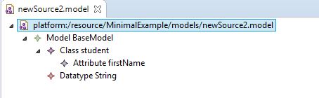

Re: Run Etl [message #1797648 is a reply to message #1796399] Sat, 03 November 2018 16:06 Go to previous messageGo to next message
Hello Dimitris,
Thank you for your answer. Yes that's right, also I know that the ETL engine maintains internal traceability links to compute equivalent[s]().but I want to run the "SingleValuedAttribute" directly with using the Transform(..) method. Due to command"c.table ::= a.owner", first I run the "Class2Table" directly with using the Transform(..) then I run "SingleValuedAttribute" directly with using the Transform(..) ,but the created Target Model is wrong [1]. Actually in the command "c.table ::= a.owner" , the equivalent of" a.owner" isn't detected and the Property "Table" for the Column "firstName" isn't set, Can you guide me to create the target model correctly?
The minimal example and SourceMode's picture are attached .
Best Regards
Marzieh

DB.getResource().getContents().add(eObject);
DB.getResource().getContents().add(eObject1);
etlmodule.getContext().getTransformationTrace().add(Element, targets, tr);
I hope this helps.
Cheers,
Dimitris
[Updated on: Tue, 13 November 2018 11:27] by Moderator
