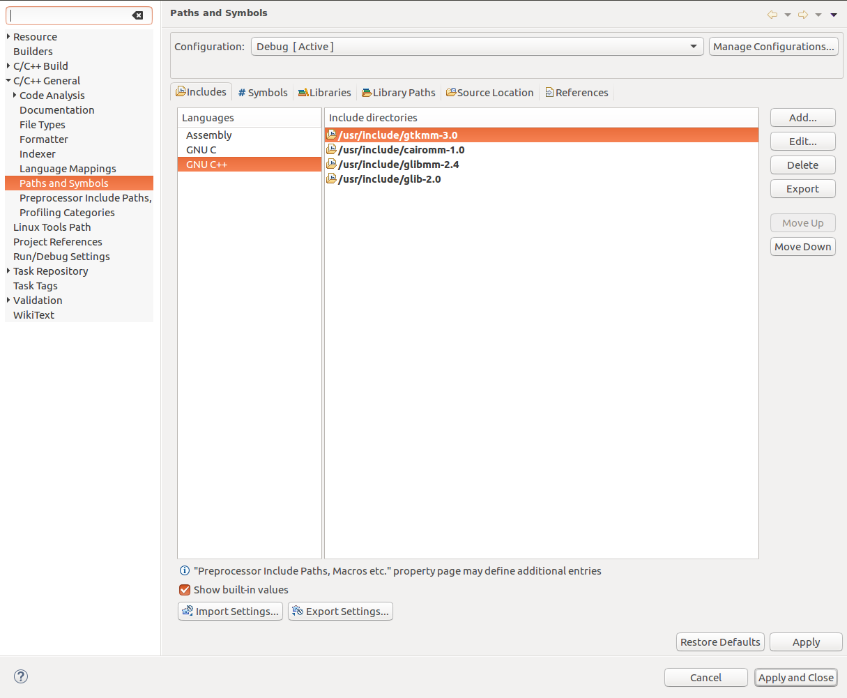

I have Eclipse Oxygen installed on Ubuntu 16.04. My program compiles, and can be run but eclipse show errors, like unresolved inclusion. (Image 1)

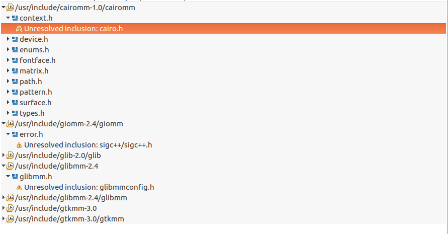

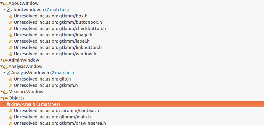

I've started adding the includes (Image 2) but new ones appears (Image 3).
I am doing something wrong? I can't remove the errors ...

You likely aren't telling the Indexer all of the necessary include paths.
This is the output of pkg-config under Fedora for gtkmm-3.0
$ pkg-config --cflags gtkmm-3.0
-pthread -I/usr/include/gtkmm-3.0 -I/usr/lib64/gtkmm-3.0/include -I/usr/include/atkmm-1.6 -I/usr/include/gtk-3.0/unix-print -I/usr/include/gdkmm-3.0 -I/usr/lib64/gdkmm-3.0/include -I/usr/include/giomm-2.4 -I/usr/lib64/giomm-2.4/include -I/usr/include/pangomm-1.4 -I/usr/lib64/pangomm-1.4/include -I/usr/include/glibmm-2.4 -I/usr/lib64/glibmm-2.4/include -I/usr/include/gtk-3.0 -I/usr/include/at-spi2-atk/2.0 -I/usr/include/at-spi-2.0 -I/usr/include/dbus-1.0 -I/usr/lib64/dbus-1.0/include -I/usr/include/gtk-3.0 -I/usr/include/gio-unix-2.0/ -I/usr/include/cairo -I/usr/include/pango-1.0 -I/usr/include/harfbuzz -I/usr/include/pango-1.0 -I/usr/include/atk-1.0 -I/usr/include/cairo -I/usr/include/cairomm-1.0 -I/usr/lib64/cairomm-1.0/include -I/usr/include/cairo -I/usr/include/pixman-1 -I/usr/include/freetype2 -I/usr/include/libpng16 -I/usr/include/freetype2 -I/usr/include/libdrm -I/usr/include/libpng16 -I/usr/include/sigc++-2.0 -I/usr/lib64/sigc++-2.0/include -I/usr/include/gdk-pixbuf-2.0 -I/usr/include/libpng16 -I/usr/include/glib-2.0 -I/usr/lib64/glib-2.0/include
Note that some of them are not in /usr/include
For example, glibmmconfig.h is in /usr/lib64/glibmm-2.4/include
$ find /usr/lib64  -name "glibmmconfig.h"
/usr/lib64/glibmm-2.4/include/glibmmconfig.h
You probably don't need all of them.
You'll have to chase down what you need then add them to your project.
It's going to be tedious.
Also wouldn't hurt to rebuild the Index after setting the include paths.
Project --> C/C++ Index --> Rebuild
