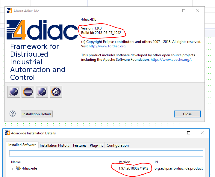

Re: FORTE Monitoring: no error message after giving invalid force value? [message #1789996 is a reply to message #1789992] Fri, 01 June 2018 16:25 Go to previous messageGo to next message
By the way: Why is the version number mentioned under menue Help -> About 4diac-ide not the same as under "Installation Details"?
index.php/fa/32993/0/
Re: FORTE Monitoring: no error message after giving invalid force value? [message #1790037 is a reply to message #1789996] Sun, 03 June 2018 15:56 Go to previous message
I just added the version number to the bugzilla and updated your bug-report.
Thanks for noting this. I thought that the about dialog takes the information from the product configuration. As I found out now it is taken from the main plugin. I'll note this for the next release.
