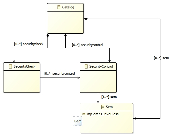

Re: Ecore: Type parameter for interface implementation? [message #1787644 is a reply to message #1787641] Wed, 30 May 2018 07:45 Go to previous messageGo to next message
Ed Willink wrote on Wed, 30 May 2018 07:32
Perhaps a 'UML' diagram might make everything clear.
Sure!
Here we go.
I attached an example which hopefully makes clear what I am trying to accomplish.
In this example, I want to manage a catalog of security checks. Every security check may have a number of security controls.
While, in turn, every security control is carried out by executing code, available as Java classes which all implement the "ISem" interface.
[Updated on: Wed, 30 May 2018 07:51] by Moderator
Re: Ecore: Type parameter for interface implementation? [message #1787647 is a reply to message #1787644] Wed, 30 May 2018 08:15 Go to previous messageGo to next message
I don't see a particular problem. EMF supports generics, although they can be difficult to get right. I often resort to looking at the Classic OCL models where generic classes are refined by Ecore/UML variants.
If you have a Papyrus UML diagram, you might see whether UML2Ecore (from the UML Model Editor toolbar menu for a Package works out of the box.)
Otherwise it is difficult to guess at what you have done wrong.
Ed Willink
