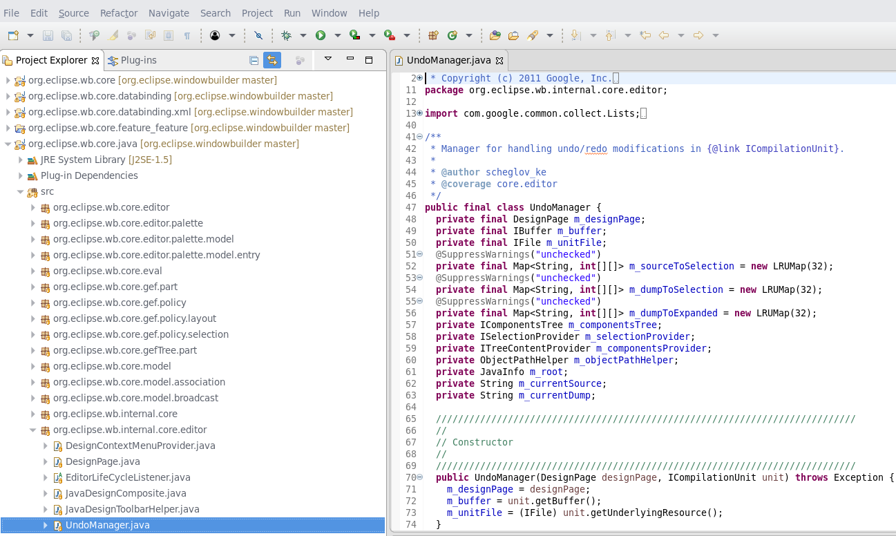

Re: WB not working in Linux and Windows 7 + Photon 4.8.0RC1 [message #1790273 is a reply to message #1790031] Thu, 07 June 2018 13:24 Go to previous messageGo to next message
Avi Abrami wrote on Sun, 03 June 2018 19:01
I'm not answering your question, but rather using it to make a non-related point.
File "UndoManager.java" is _not_ in the Git repository that [supposedly] contains the WindowBuilder source code. Why is that?
Hi Avi,
I cloned WB source code from its Git repository (see also https://www.eclipse.org/forums/index.php/t/1093240/)
which is the following
git://git.eclipse.org/gitroot/windowbuilder/org.eclipse.windowbuilder.git
and I can assure that file "UndoManager.java" is there (see image)
index.php/fa/33042/0/
You'll see it also here:
https://git.eclipse.org/c/windowbuilder/org.eclipse.windowbuilder.git/tree/org.eclipse.wb.core.java/src/org/eclipse/wb/internal/core/editor
Are you cloning from the same Git repository?
  • Attachment: WB-class.png
    (Size: 226.56KB, Downloaded 2735 times)
[Updated on: Thu, 07 June 2018 13:31] by Moderator
Re: WB not working in Linux and Windows 7 + Photon 4.8.0RC1 [message #1790431 is a reply to message #1790273] Sun, 10 June 2018 14:59 Go to previous messageGo to next message
Thank you Vincenzo.
Your screen shot led me to discovering how to correctly download the WindowBuilder source code.
Thanks!
