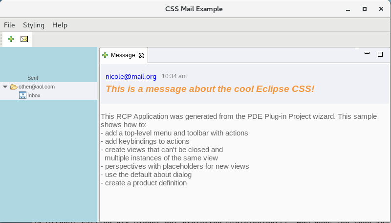

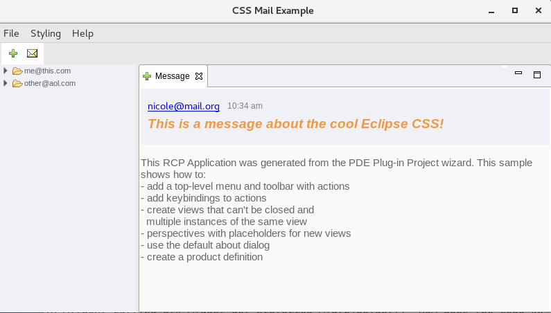

We have a RCP application using CSS for styling. It works fine on win; but on Linux, the tree selection is messed up. The problem can be duplicated with the attached mail example.
When the application is started, it shows as in start.png; with some selection/expansion on the tree, it shows as in withSelection.png.
If I remove "swt-selection-background-color: #AFD7E1" from the default.css tree element, the problem goes away.
Tree {
color: #000000;
background-color: #ffffff;
swt-selection-background-color: #AFD7E1;
swt-hot-background-color: #DAECF0;
swt-selection-border-color: #AFD7E1;
swt-hot-border-color: #DAECF0;
I am wondering if this is a know issue? Or some setting on the linux machine (using CentOS) that might cause the issue? Any suggestions on how to solve it?
