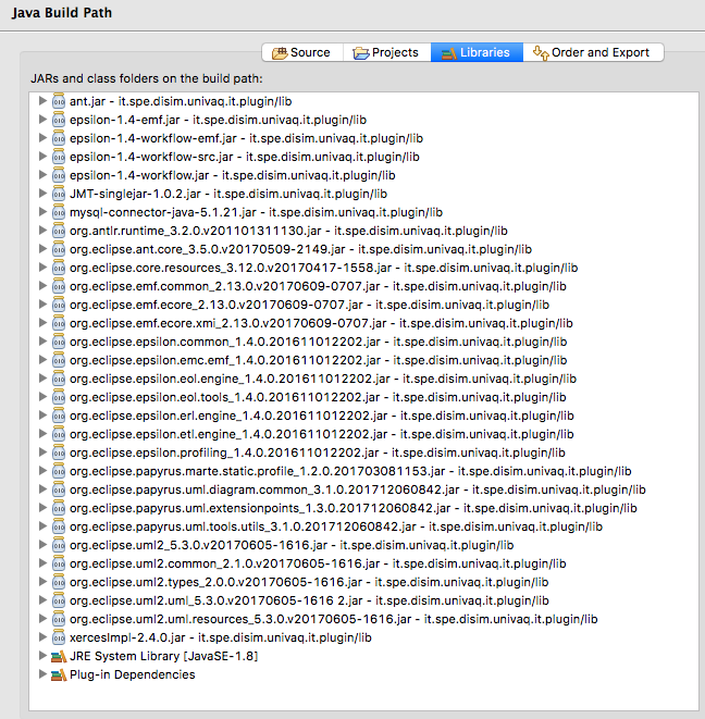

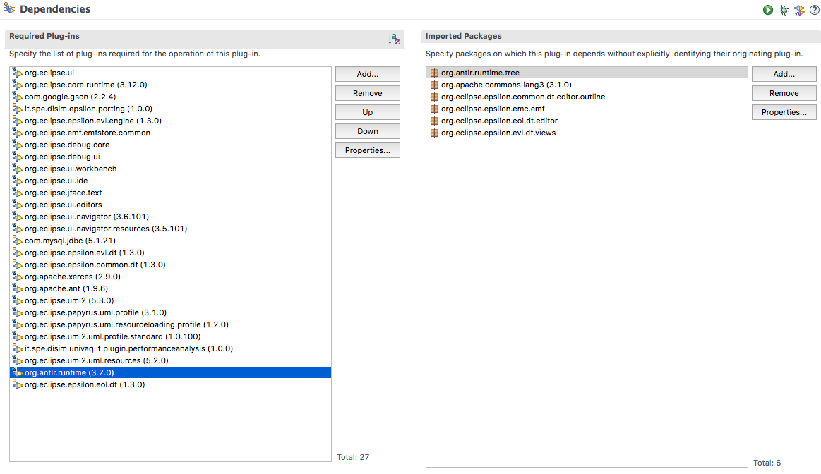

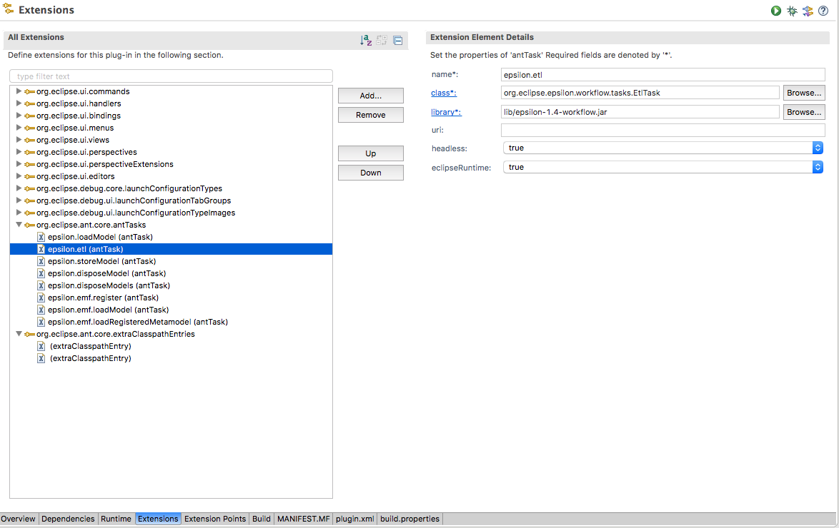

In addition, please find attached:
- a screenshot of all the plugin dependencies of my main project.
- a screenshot of the java build path libraries of my main project.
- a screenshot of all the extensions defined by my main project, with emphasis on epsilon ant tasks.
Could it be that one of those imported jars overwrite the correct antlr?
Thank you for your help, best regards,
Davide

Re: Executing an ant build file programmatically which, in turn, executes an etl transformation [message #1790230 is a reply to message #1790182] Thu, 07 June 2018 05:57 Go to previous messageGo to next message
Hi guys,
I would let you know that I have solved my problem.
As supposed, some dependencies of my main project were using an old version of ant runtime, taking priority over the one I selected.
In particular, I had some dependencies to the 1.3.0 version of epsilon eol, evl, and common. I removed those dependencies and everything started to work properly :)
Thank you for your time and support.
