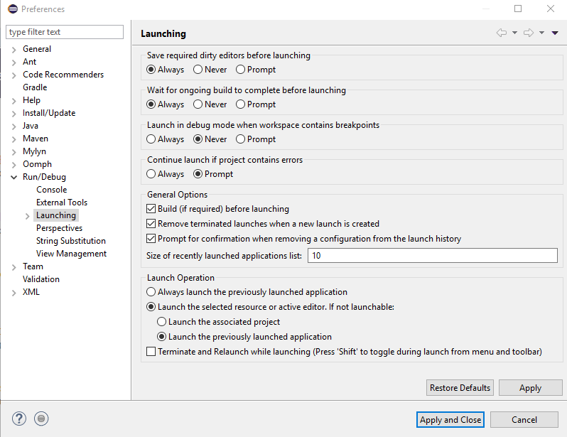

I've never been to that page before, so I don't know if that could have happened accidentally? I don't understand most of the technical terms used in Eclipse yet, so I can't tell if one of my settings on that page needs to be adjusted. Here's what my launching preferences look like currently.

Uncheck "launch the previously launched" box near the bottom. Alternatively, hit the button to restore initial parameters.
Re: Run Different Program? [message #1787352 is a reply to message #1787351] Wed, 23 May 2018 23:14 Go to previous messageGo to next message
I'm already at the default parameters, so "launch the selected resource or active editor" is already selected. I've never changed any launching preferences before, so I'm not so sure this is the issue. Could uninstalling and reinstalling Eclipse help somehow?
