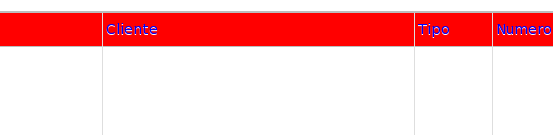

This is how the table header appears at first
index.php/fa/32890/0/
that's because of the base CSS is the following
TableColumn {
  color: #0000FF;
    background-image: gradient(
    linear, left top, left bottom,
    from( #ff0000 ),
    to( #ff0000 )

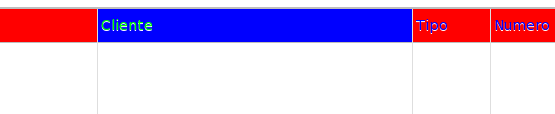

then, when I click on a button, I do this programmatically
TableColumn[] columns = table.getColumns();
columns[3].setData( RWT.CUSTOM_VARIANT, "other" );
and that's what happens immediately
index.php/fa/32891/0/
thanks to the following CSS
TableColumn.other {
  color: #00FF00;
    from( #0000FF ),
    to( #0000FF )
If that's not happening to you, the only reason I can think of is that you aren't handling the ServerPushSession (start/stop). In this case, try to do start it, e.g. when creating the composite, with:
ServerPushSession pushSession = new ServerPushSession();
pushSession.start();
(although at some point you should call also .stop())
Let me know what's not working for you.
