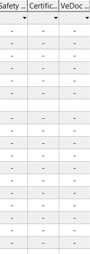

I am facing two issues with filtering below i am giving a brief description for it kindly help me out to resolve it:
1)We have 3 columns with only possible data being + and - .I have added a combo filter to filter + and - .Filter works fine when for below combinations:
a) +,+ and -
b) -,- and +
where as when i apply the below combinations it doesn't work:
c) -,+ and +
d) +,- and +
e) -,+ and -
f) +,- and -
(In other words i feel there is a issue with already applied filter data value)
screenshot1.GIF attached

1) I suppose you run into a bug in NatTable 1.5. There a mechanism was contributed to increase the filter performance for multiple filter criterias, but for equal values the caching is not working correctly. We fixed that in the development branch which we hopefully soon will release as 1.6.

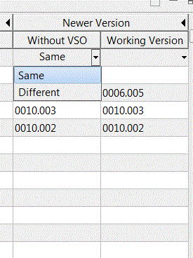

Dirk i am trying to add some custom filters for the columns .Below is the snapshot for the same.
Kindly give me hints on how to get this done .https://www.eclipse.org/forums/index.php?t=getfile&id=32837&
Re: Filtering clarifications [message #1789868 is a reply to message #1789555] Thu, 31 May 2018 02:08 Go to previous messageGo to next message
You need to implement a custom IFilterStrategy where you evaluate the value and set your matcher for that value.
