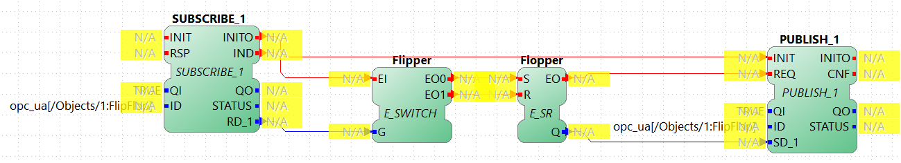

Dear all,
libstdc++6 was already installed but it didn't work either for jessie.
I've managed to get forte to run now by changing the OS to Raspbian Stretch.
So... to carry on with the OPC-UA tutorial. I went about doing the flipflop app and I realise the monitoring function isn't working on the RPI. All the values show N/A. I replicated the same app on windows running forte as a localhost and monitoring works fine.
Did i miss out on any extra steps to activate monitoring for the RPI? I've double checked "FORTE_SUPPORT_MONITORING" for cmake options and its set to ON by default.
Monitoring used to work for me on forte v1.8.4 for the RPI. Can't remember if there was anything special that was needed to enable monitoring.
Thanks for the help!

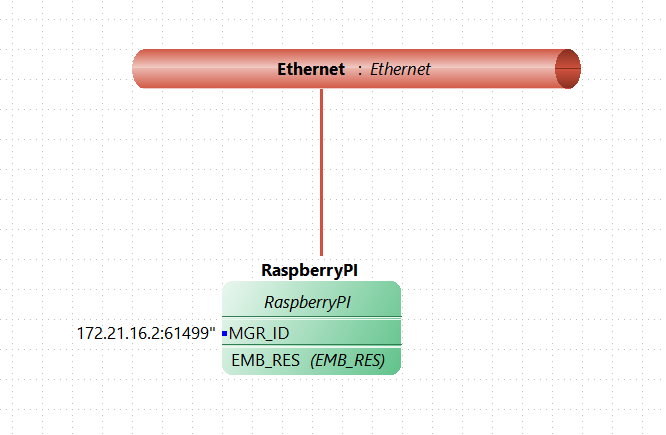

Re: Forte v1.9 with open62541 on RPI [message #1787476 is a reply to message #1786957] Sat, 26 May 2018 01:34 Go to previous messageGo to next message
Dear Dr. Alois,
Sorry for the late reply. Attached are the details you requested.
There's only one RPI running on the same IP address. Seems like from the log, there is no viable address to monitor from but the application deployment to the RPI is actually successful as i could see those OPCUA variables from UaExpert.
Daniel
Re: Forte v1.9 with open62541 on RPI [message #1787495 is a reply to message #1787476] Sat, 26 May 2018 15:20 Go to previous message
Dear Daniel,
thanks for all the infos. I'm not sure how to interpret the log. But I see that you have a double quote at the end of your MGR_ID config value. This is an invalid value. It looks like that the deployment handles this more gracefully compared to the monitoring. Could you try to remove the double quote at the end and check if it is then working?
