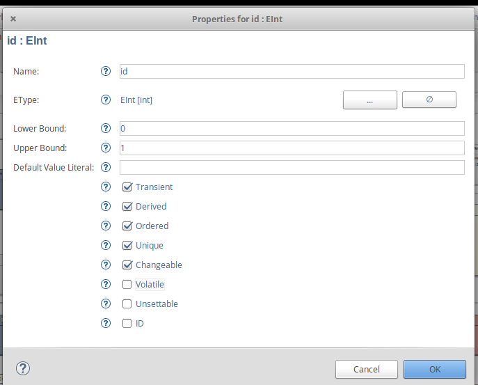

when I set up the ID feature as you suggested, I noticed the ID's returned to 0, for all objects.
I noticed too that IDs weren't available anymore to user edition in the properties window.
Look how I did.
  • Attachment: 1.png
    (Size: 40.29KB, Downloaded 147 times)

Your original question was:
"I would like to know if it is possible to set an id feature of an object with 1 when the user creates it the first time. Then, other objects of the same type would have that id automatically incremented."
Of course it should not be edited since edits will not be saved; IDs are created lazily after loading. If you now want to allow editing you need to have a very clear plan for resolving clashes between new/copied/loaded/manually-re-used IDs.
I suggest you go back to the problem and work out what problem you are trying to solve. Then you may be able to formulate the requirements for your solution.
Ed Willink
