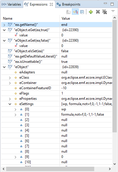

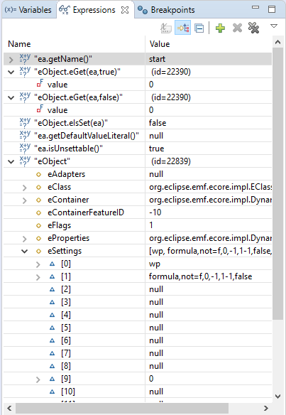

I load a model from its XMI file, where I have an eObject with two attributes of type EInt called "start" and "end" and with unsettable = true. The first one is not set and the second one is set to "0"; if I open the file as text, I can see that the value of "end" is explicitly set:
index.php/fa/32761/0/
When I parse the values from the file, I need to distinguish between both cases. However, the result of calling EObject::eGet(..) and EObject::eIsSet(..) is always the same, as shown below:
Start
index.php/fa/32759/0/
End
index.php/fa/32760/0/
Any idea what may be causing this?

After trying the toy example and comparing it with my code's behaviour, I realised it was my mistake for not handling IResources properly (I was obtaining an older version of the same model without the attributes). So once I ruled out that it was the APIs fault, I was able to look in the right place and fix it.
